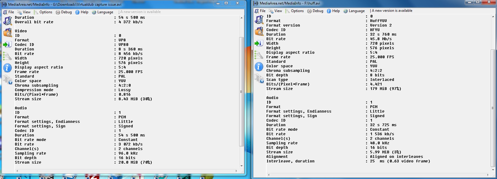

    I have attached the mediainfo report of your file with a comparison of one of my captures using vdub. You will note the disparity between the video and the audio.
    PCM should only be 1536 kb/s. How you have arrived at double this is beyond my comprehension since there is no actual setting for PCM audio. It is strictly uncompressed.
    Your video using vp8 is highly compressed and your PC will have to work harder to compress at the same time as capturing. And that can also lead to dropped frames (not checked due to the throttling)
    But as to your other issue I am sorry I do not have a clue.

  9. Originally Posted by DB83 View Post

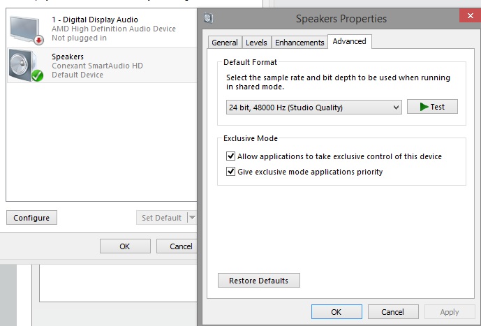

    The Advanced tab in sound is set to 24 bit, 48000 HZ (Studio Quality)
    [Attachment 62514 - Click to enlarge]
  20. Member DB83's Avatar
    Jul 2007
    Not relevant since that is a playback device. Check the recording devices.

  21. Member Cornucopia's Avatar
    That is the settings for your sound card's playback. That has nothing to do with the settings for capture or for compression.
