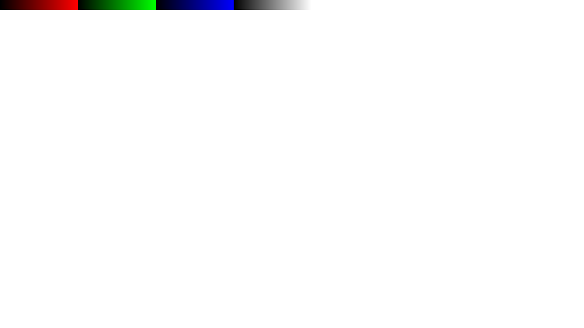

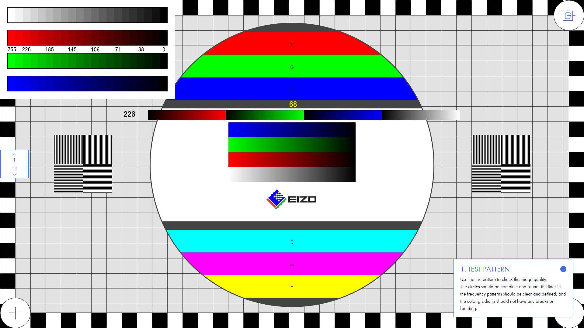

  1. I know that to get 8 bit rgb I need to use a 10 bit or more yuv. I couldn't find yuv444p10le, so I chose yuv444p16le (but ffprobe shows yuv444p10le anyway).
    ffmpeg -y -vsync 0 -i %01d.png -pix_fmt yuv444p16le -c:v hevc_nvenc -tune lossless out.mov
    ffmpeg -i out.mov -pix_fmt rgb24 img/out-%03d.png
    ffmpeg -i img/out-%03d.png -i %01d.png -filter_complex ssim -f null -
    SSIM R:0.999988 (49.290492) G:1.000000 (inf) B:0.999971 (45.373878) All:0.999986 (48.665779)
    The result is not lossless. What am I doing wrong?

  6. Try to verify steps so for example at first skip nvenc, secondly use software x265 - perhaps nvenc is not lossless...
  7. x265 shows the same result.
  8. Originally Posted by qo4on View Post
    ffmpeg -i 1.png -vf scale=out_color_matrix=bt709,format=yuv444p10le -c:v libx265 -x265-params lossless=1 libx265.mp4
    ffmpeg -i libx265.mp4 -vf scale=in_color_matrix=bt709,format=rgb24 libx265_to_png.png
    ffmpeg -i libx265_to_png.png -i 1.png -filter_complex ssim -f null -
    [Parsed_ssim_0 @ 000000b166aa1d40] SSIM R:1.000000 (inf) G:1.000000 (inf) B:1.000000 (inf) All:1.000000 (inf)
  9. Will you be able to compare source and decoded result (for example by subtracting) it could be interesting to check whether issue is in levels or in edges (simplification for this discussion).
    Alternatively you can try to sent RGB without conversion to YUV - perhaps this can be issue.
    Of course as always with NVEnc you should use latest NVidia API version.
  10. Originally Posted by poisondeathray View Post
    Thank you! You are right. Your settings are truly lossless, all pixels are exactly the same with a difference of 0. Nvenc is also lossless.
    Do you know why ffmpeg uses yuv444p16le even though I specified yuv444p10le? Although checking after conversion with ffprobe shows that the file is yuv444p10le:
