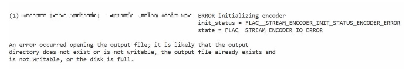

    Today I tried doing something I had never done: converting wav files to flac. And I'm getting error.
    This the error I get.
    I wonder if it's not a problem with Windows 10 or its latest update.
    Any hints?

  2. The error message says:
    Not enough space or not enough rights to write onto the target location

    Enough space is not true, but I had tried that same SSD (which is not C) and disk C, with same results.
    Now I tried with disk J, and the conversion went through.
    So how do I do, the Administrator, do get all my administrator's rights, which seems to be what is happening?
    That is something that sporadically has happened in the past and I never learned to solve it properly.
    Thanks, BTW...

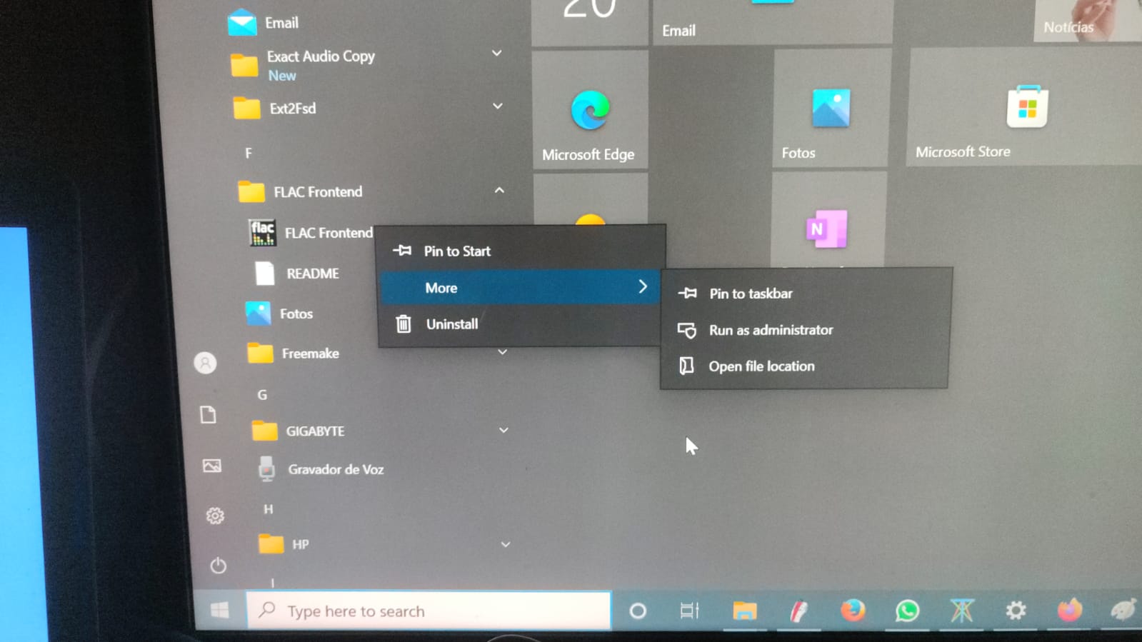

    I will do that. But for this case I found out another way.
    Using this access that provides administrator rights for the program.
    Is that OK?

    Why would a GUI flac front-end need Admin rights? That doesn't make sense
    I ran the compatibility troubleshooter; it fixed the problem, program starts with a double click and works properly now
