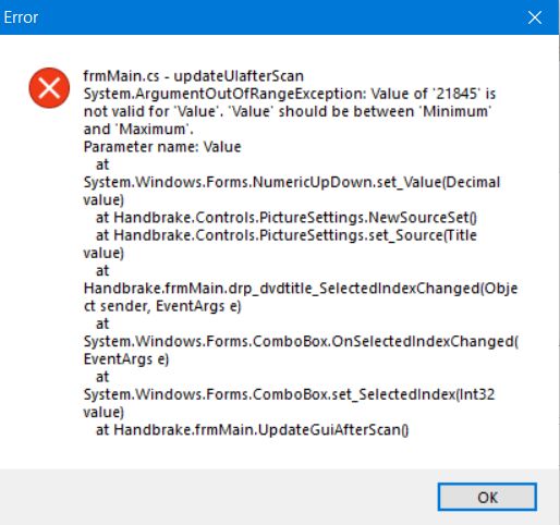

    Handbrake's always worked for me, except for one file. I keep trying to put a movie in that's 1.7...something gb, and would like to make it smaller. But it won't accept the file. It keeps giving me this warning. Maybe someone here knows what's going on. I sure don't.Image
    [Attachment 62453 - Click to enlarge]

  4. The value for numericupdown is outside the allowed range, which means that in the analysis an illegal value is determined by handbrake.
    This can be a program error or a problem with the file.
    Try to remux the file with mkvtoolnix to mkv and then load the new mkv into handbrake.

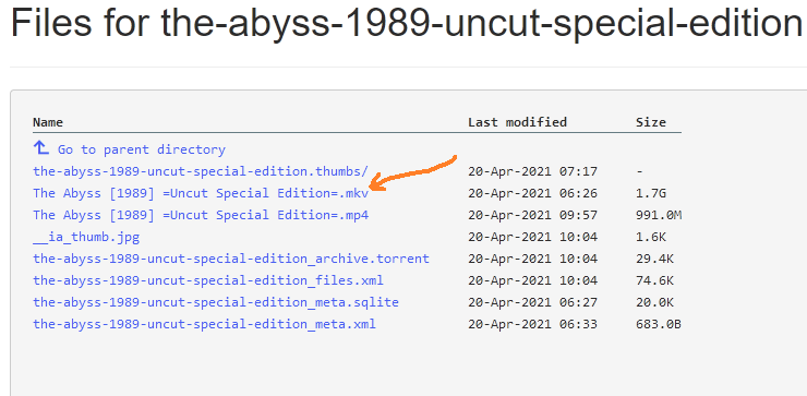

    I see a 1.7 GB MKV file. Is trhat what you downloaded?

    Mar 2008
    the MKV ...

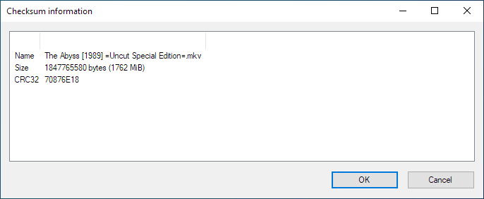

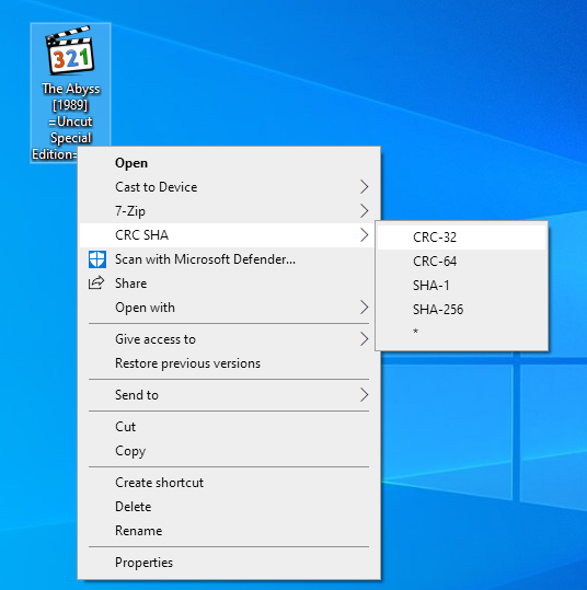

    I downloaded the MKV and it opens in Handbrake without issues. Perhaps your download is bad
    check the CRC32 value
