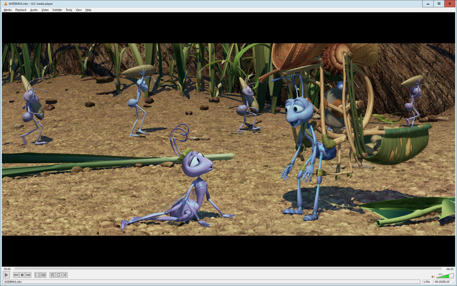

  11. The two videos render (with tone mapping) the same here with MPCBE and VLC. I can't get MPCHC to tone map but it renders both the same (low contrast and washed out colors). I demuxed the videos to raw h.265 streams -- the two were 100 percent identical up to the point where one ended (one is a little longer than the other).
    How are you comparing the two videos? Two instances of the same media player side by side? Be careful with that -- the same player playing the same video can look different when used that way (especially on older computers) because one may get hardware decoding and display, the other software. Two different media players? Different players may use different tone mapping -- so that could account for differences.
    In post #7 you appear to be remuxing from m2ts to mkv. But you uploaded two mkv files for comparison.
    Are you really using Media Player Classic? Last updated in 2010?
    VLC playing the two videos (display reduced to 50 percent so the images fit on screen):
    [Attachment 62449 - Click to enlarge]
    [Attachment 62450 - Click to enlarge]
