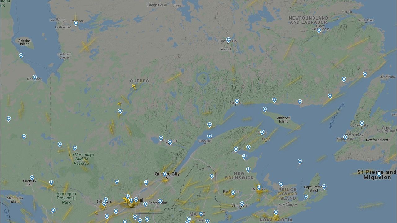

    Hi folks. Here's the project.
    I configured an auto screenshot program to capture planes position in the sky at flightradar24.com and I want to import the image sequence in virtualdub to make a timelapse of the position of the planes BUT I want the screen to get filled with planes colors everywhere a plane ever passed thru since the beginning, leaving unaffected areas where no plane ever passed.
    I first though I could use something like temporal smoother and crank it to the max but it doesn't work.
    Got any idea which plugin could be use to "add the difference" to the next image and keep adding it until the screen is filled with what has moved?

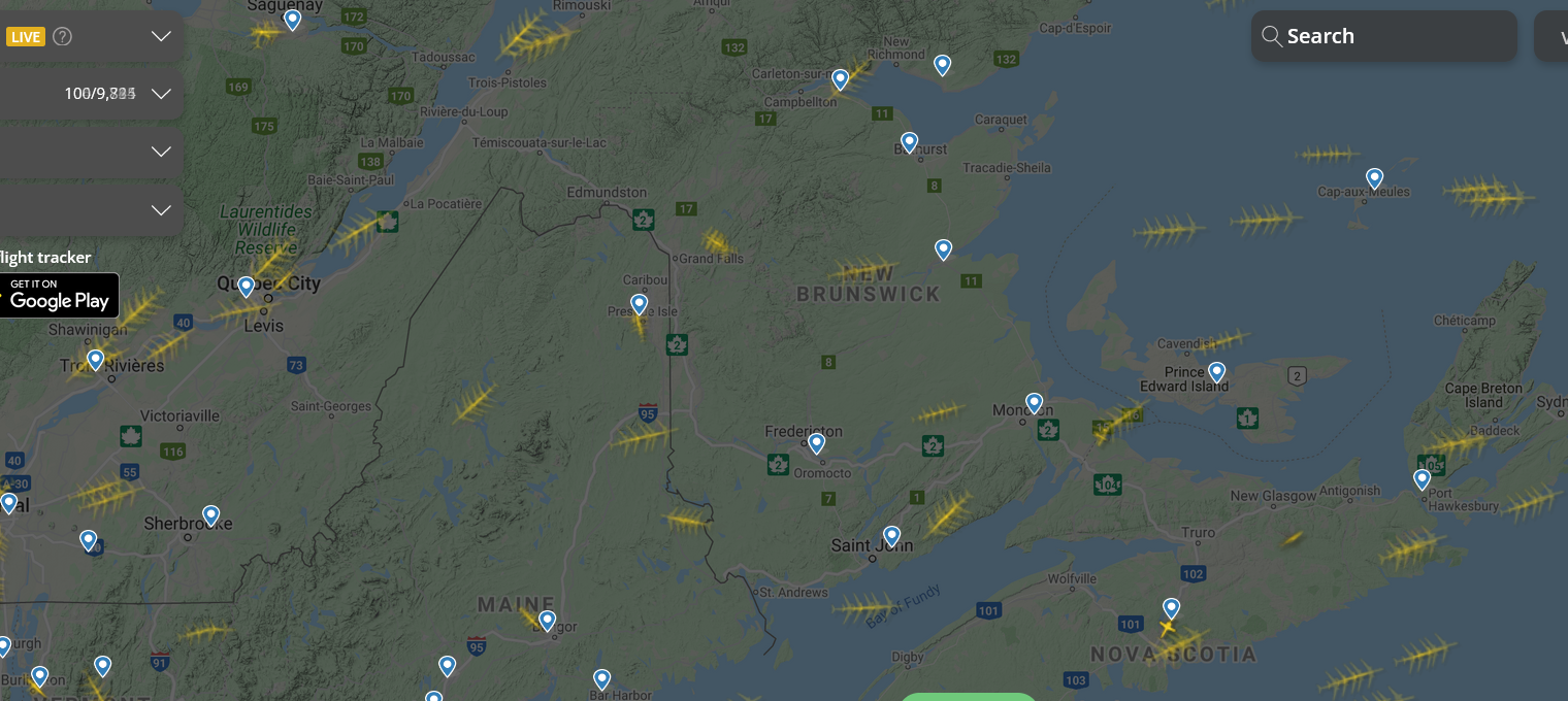

    I did tried ClipBlend but unfortunatley, it doesn't do what i'm trying to achieve...
    The planes make some blurred tails but the tails quicky fade out and nothing appear on the image anymore but the background map...
    I want the map to get all yellow where plane previously passed and stay yellow forever...Image
    [Attachment 62384 - Click to enlarge]
    The goal is to figure out areas where little or no planes fly above...

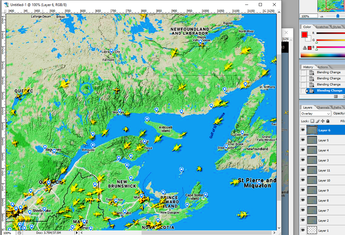

    It works with overlay in photoshop... but I would need a transparent background around the planes... and it's pain in the ass to do it manually, did 10 frames, i want to import thousand of em...Image
    [Attachment 62385 - Click to enlarge]
  8. Can you upload a few images for testing in a zip file ?
    What blend mode did you use in photoshop ?
    There is a way in avisynth with overlay for frame accumulation, but you will probably run into memory problem with 1000 images
    If the planes are bright, then using "lighten" mode should accumulate them, leaving the BG intact

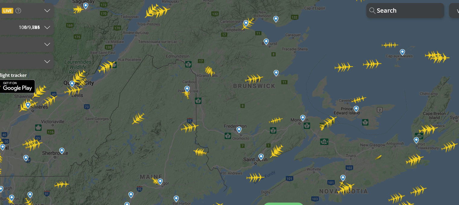

  9. This is what clipblend (default settings) looks like on 5 frames
    [Attachment 62386 - Click to enlarge]
    and scriptclip with overlay in lighten mode on the same frames
    [Attachment 62387 - Click to enlarge]
    Apr 2020
    Canada
    That is exactly what i'm trying to get. What script did you use?

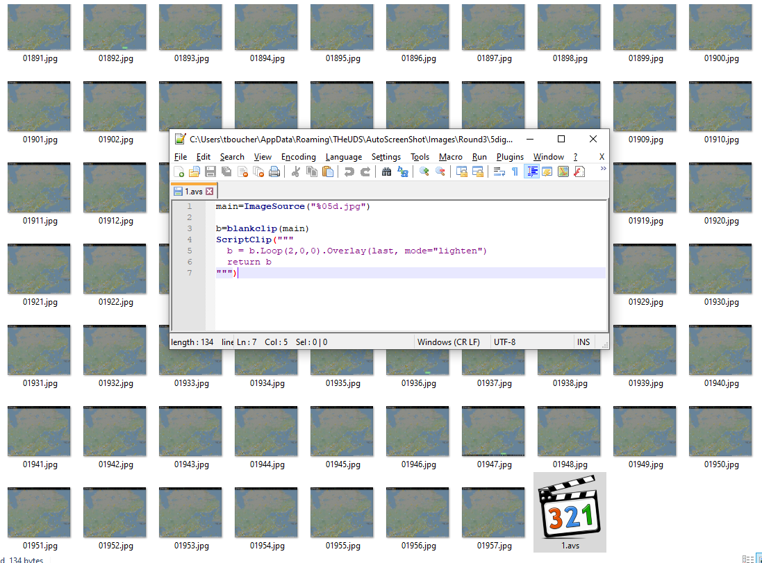

    Good morning. Renamed my jpg with 5 digit structure and made the mod in the script you gave me but I get no output even from the frameserver.
    Do anything need to be loaded above the script?
    It seems that
    ScriptClip
    blankClip
    ImageSource are all functions integrated within avisynth natively?
    [Attachment 62393 - Click to enlarge]
  17. Is there any error message? You can load the .avs into vdub2 or mpchc to preview script . Save the script changes first before previewing
    Make sure your paths are correct
    e.g. if image sequence was located in c:\folder
    You can add start, end arguments, fps
    main=ImageSource("c:\folder\%05d.jpg", start=1891, end=1957, fps=24)
    Yes, scriptclip, blankclip are internal avs functions
    scriptclip requires linear sequential access . If you wanted to make an animation, you could (just encode the script); but if you only wanted the final image, you cannot "skip" or "jump" to the end. You have to "play" the script or frame advance to go to the end, so each frame is sequentially "overlaid" .

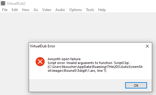

    Well, virtualdub returns the proper error. not sure why mpchc doesn't
