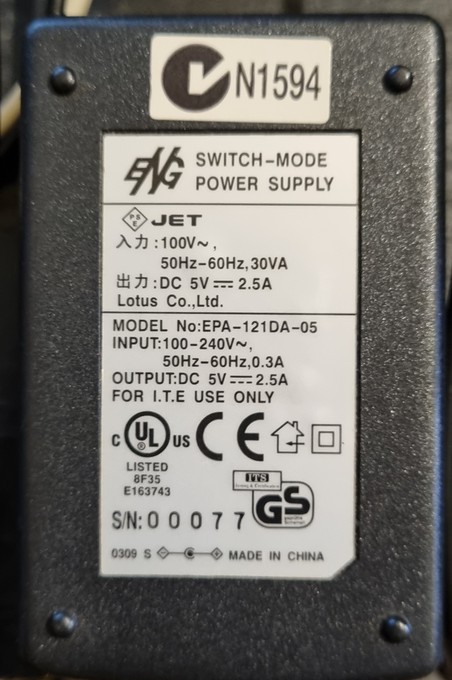

    I need help, please.
    I have Canopus ADVC-100, brilliant peace of hardware,
    but unfortunately, lost A/C adapter.
    I have plenty different A/C 5V adapters in my home
    (from old Monitor, WiFi router, old LapTop, etc...),
    but I do not know how many Amperes ADVC-100 needs.
    Someone who has original Canopus ADVC-100 A/C adapter,
    would you be so kind to read on placard how many Amps
    is on Output.
    Many thanks in advance.
    Zax

    According to this, https://cvp.com/pdf/canopus_advc100.pdf, it draws 5.5 watts so 1.1 amps should do but I'd go with 1.5 - 2 amps to be safe.
    May 2005
    Australia-PAL Land
    Dec 2021
    Hungary
    Wow! Alwyn, Zing, thank you sooo much!
    May 2005
    Australia-PAL Land
    My pleasure!
