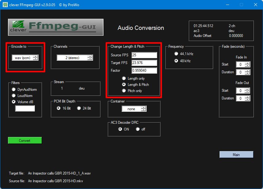

    1. Select the desired audio stream from video1.
    2. Load it into clever ffmpeg-GUI, click main, click convert audio stream, click continue, select values like in the marked areas in the picture, leave all other settings as they are and click convert.
    [Attachment 62335 - Click to enlarge]
    3 If done, simple convert one audiostream from video2 to wav.

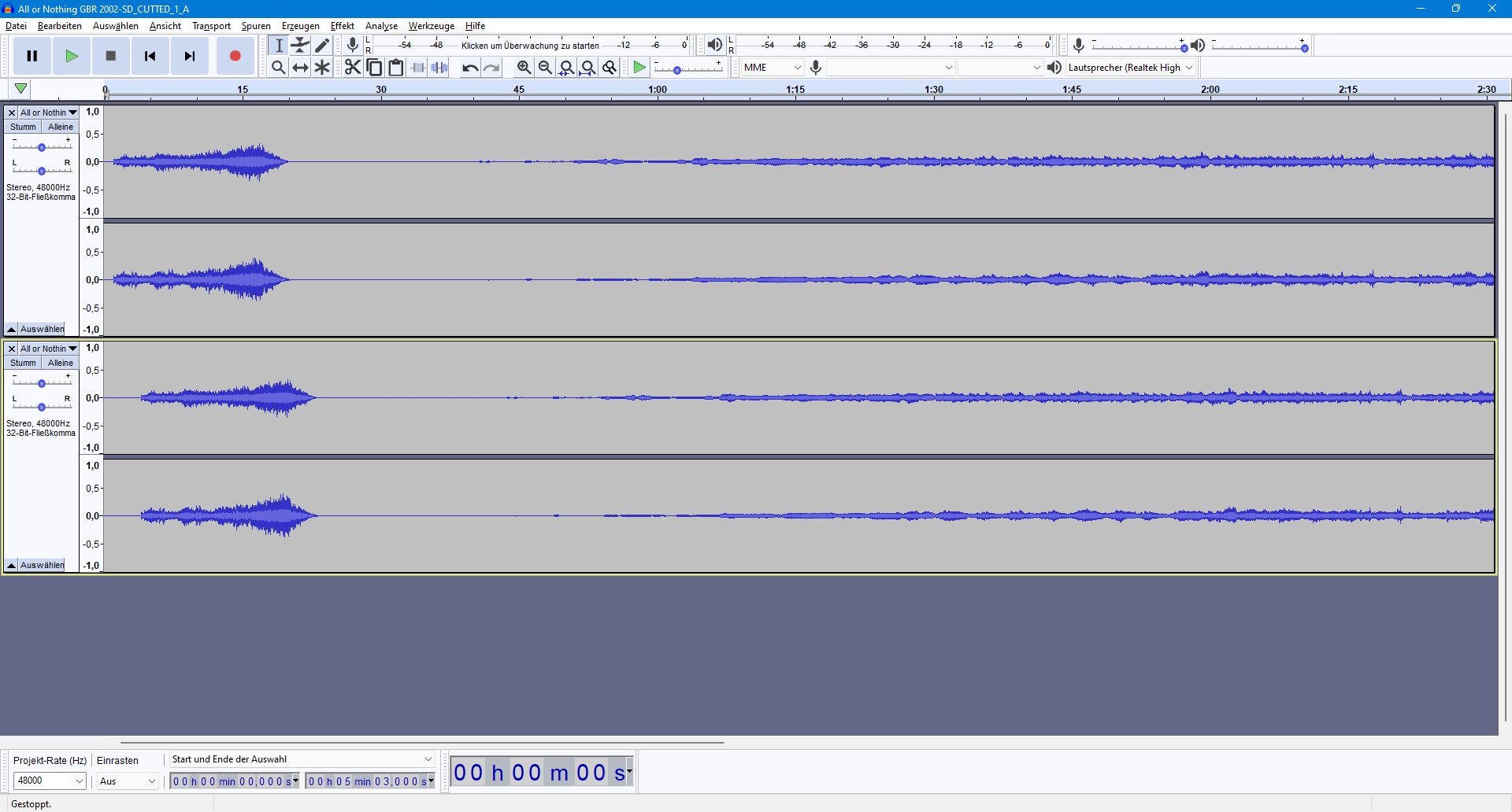

    4. Import the converted wav from video 2 into audacity (as reference)
    5. Import the converted wav (from step 2, from video 1, 25fps->23.976fps) as 2nd audio.
    [Attachment 62336 - Click to enlarge]
    6. Adjust the lower (the desired one) stream to the upper reference stream. If finished, save your work.
    7. Convert the corrected wav to aac/ac3, if you want, and remux it to video 2.
