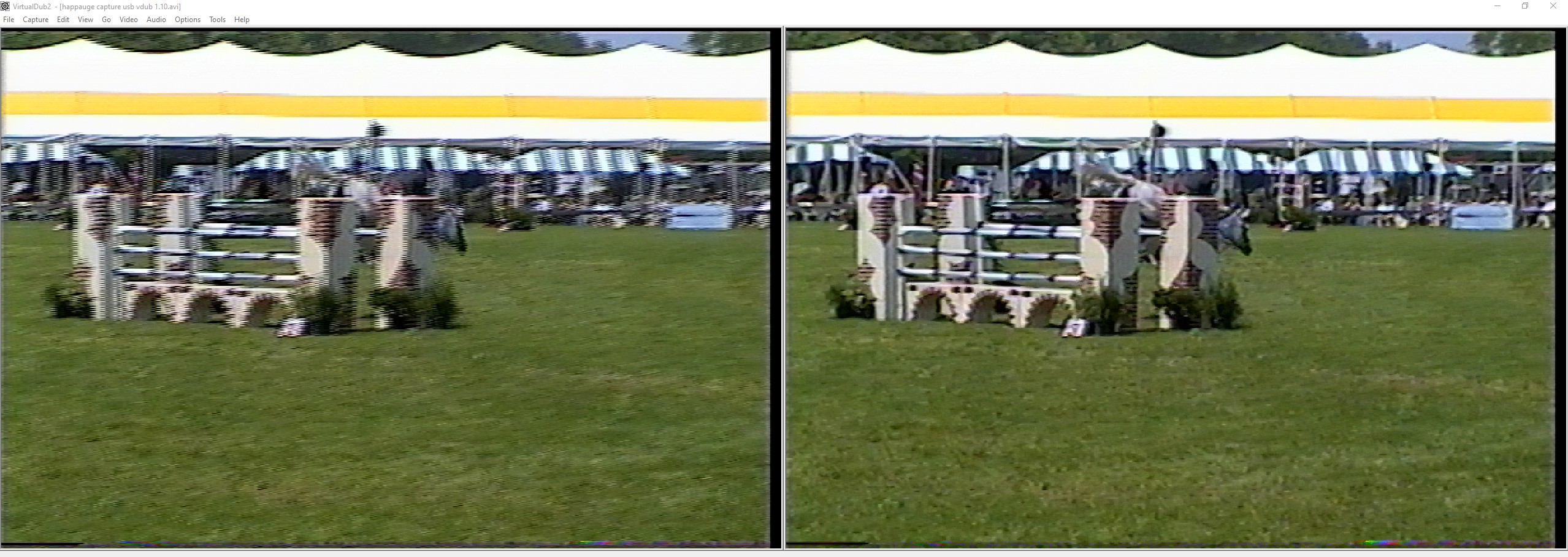

    There is baked in interlacing effects, Something is terribly wrong with your sample, That's not how an interlaced video should look like, I even put in in vdub and separated fields and I could still see the comb teeth effect.
    Seriously?? What teeth??
    [Attachment 63127 - Click to enlarge]
    (VDub Muksun Deinterlace)

  27. Originally Posted by dellsam34 View Post
    Like Alwyn, I'm not seeing any combing after a separatefields() or bob() or qtgmc().
  28. Capturing Memories dellsam34's Avatar
    Jan 2016
    So why there is a large transision between the two fields even in slow movement scenes, look at the horse rider feet, I could not remove the interlacing effects no matter what. Havn't tried de-interlacing the footage though but it has a weird look to it. Something is wrong.
  29. Originally Posted by dellsam34 View Post
    I still don't see what you're referring to. Can you provide a sample image that clearly shows the issue? I see aliasing artifacts but that always happens with SeprateFields() or Bob().
