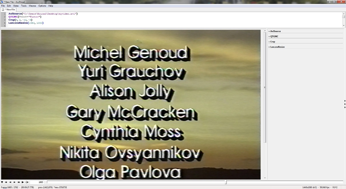

    - Vdub2 is not recommended for capturing per a lot of members here, There is an old version that works better.
    - De-interlace using QTGMC if you are comfortable with script software, top field or bottom field depends on the original video.
    - Don't crop unless you are resizing to a higher resolution 1440x1080 at least, otherwise you get line flicker artifacts when you crop and resize in low resolution setting. I personally only crop for youtube, Analog video aspect ratio by standard is 704:480 for NTSC so when you crop all around make sure you are close to that ratio (+/-4 pixels is okay), I personally prefer Lanczos.
    Here is my workflow after capturing:
    AviSource("C:\Users\PC_name\Desktop\myvideo.avi")
    QTGMC(Preset="Faster")
    Crop(8, 2, -12, -6) #These crop numbers change from video to another, this is at 700x478#
    LanczosResize(1440, 1080)
    I use AvsPmod since it shows every action I do in a video frame, after I'm satisfied with the results I hit the arrow to export to vdub2 for processing, In vdub2 I save as HuffYUV, it processes everything in one go.
