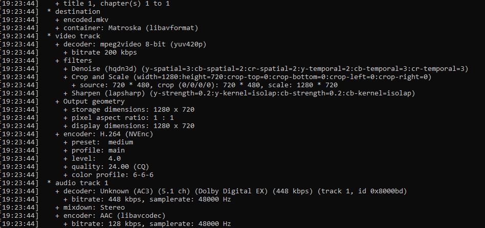

    The DOS window is showing the settings being used, and it looks like its just ignoring my directive and using a default.
    [Attachment 62287 - Click to enlarge]

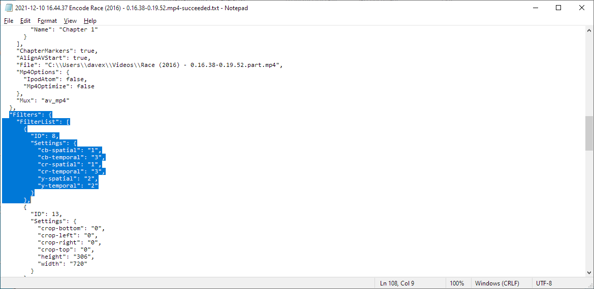

    Mar 2008
    The log shows this. Perhaps that's enough of a clue
    Not really, the JSON file is just a config file, any variable and value can be placed in any order, specifically if you look at the DOS screenshot,
    you will see the actual values, and none of them jive with the values I am assigning the filter.
    Thanks for your time brother! Ive already encoded a video with the GUI and saved both presets and CLI settings
    to JSON and neither one of them help resolve the command line syntax problem I appear to be having.

    I didnt spend the last 8 hours trying to get it to work without looking at the help file first & frequently... Google is about to shut me down for excessive use of bandwidth.
    Heres the cmd line from the batch file:
    set "quality=24"
    set "denoise=--hqdn3d 1:1:1:3:3:3"
    handbrakecli --input "%%a" --output "encoded.mkv" --encoder nvenc_h264 --crop 0:0:0:0 --width 1280 --height 720 --deinterlace --non-anamorphic --encoder-preset medium --quality %quality% --encoder-profile main --encoder-level 4.0 --aencoder av_aac --mixdown stereo --ab 128k %denoise%
    I can go back in the cmd window and see the arguments were passed correctly; HBCLI would crash out if they werent anyway...

    Does using a software encoder (eg. X264) make any difference?
  9. Member RogerTango's Avatar
    Nov 2007
    Changing it to use presets works fine even with NVENC, so I would say the software filter is getting applied to both HW & SW encoding.
    I am using the default with a simple --hqdn3d call and no arguments right now, the outcome is pretty good... I was hoping to only apply temp filtering and leave spat to nil.
    I like the way you think though!!!
    Thanks,
    Andrew
    Mar 2008
    I didn't bother with the batch variable substitution, just straight command line - this seems to work
    --hqdn3d=y-spatial=33:cb-spatial=31:cr-spatial=31:y-temporal=7:cb-temporal=7:cr-temporal=7
    I used high values so I could easy see the encode effect - the file got much smaller as the details were removed

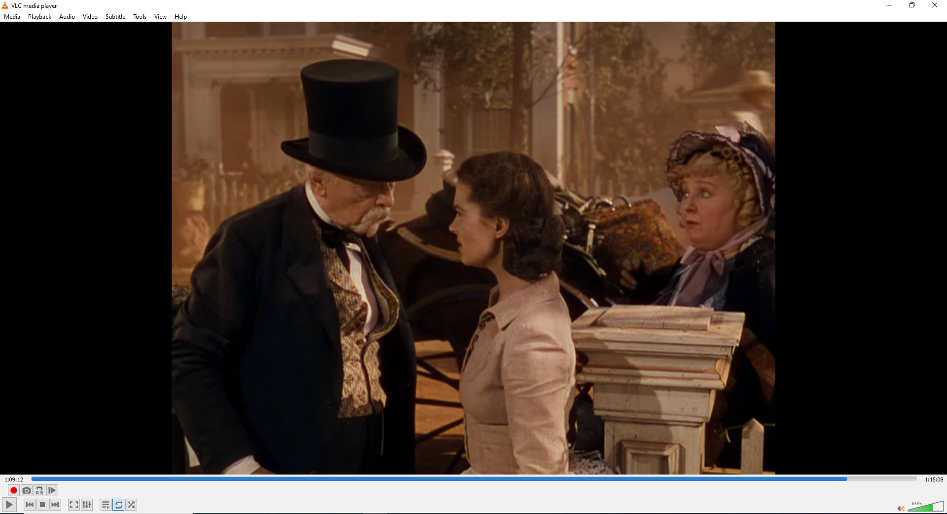

  12. Member RogerTango's Avatar
    Nov 2007
    Im glad I didnt just throw the project in the trash! I am experimenting with 1 1 1 4 4 4 and 1 1 1 5 5 5 right now, I wanted some light/medium degrain and very light "regular denoise", the results are awesome! Both SD and HD are much improved... Now Ill plug this into my batch for bulk processing.
    I own you a coffee and a hamburger, hit me up when your in town!
    The still frame does it no justice, when playing (naturally) it looks stunning!

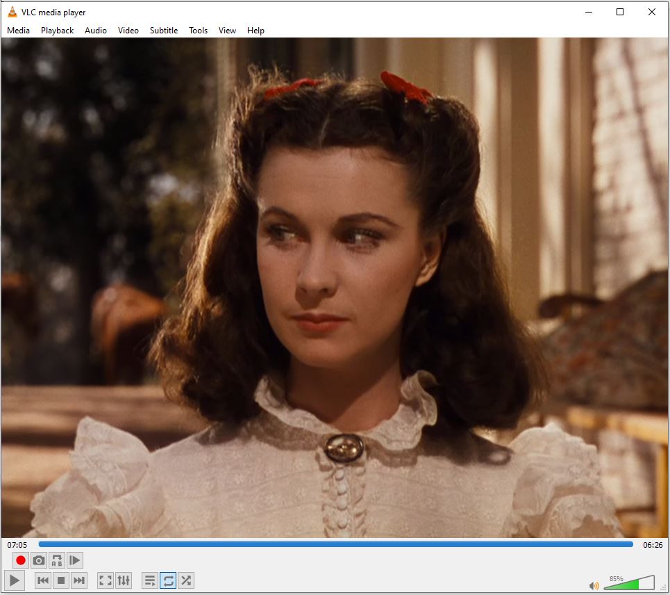

  13. Member RogerTango's Avatar
    Nov 2007
    Even stretched out on a 1080 monitor it looks good up close, where you should be seeing pronounced grain... A hint of it remains to keep it "natural". This should look awesome on a TV when you have some distance...
    [Attachment 62294 - Click to enlarge]
    All these years of programming, and I got tripped up by simple syntax. Thanks for your help!!
