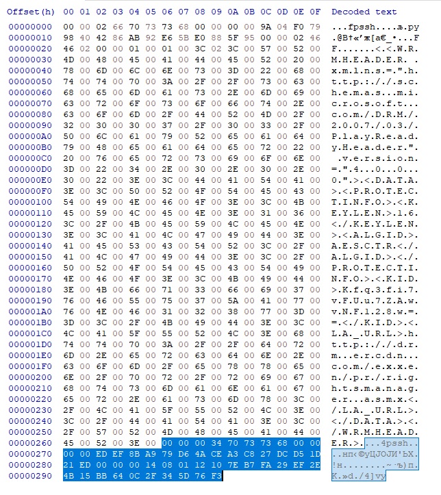

PSSH turns out to be too long how do I get it right
AAACZnBzc2gAAAAAmgTweZhAQoarkuZb4IhflQAAAkZGAgAAAQ ABADwCPABXAFIATQBIAEUAQQBEAEUAUgAgAHgAbQBsAG4AcwA9 ACIAaAB0AHQAcAA6AC8ALwBzAGMAaABlAG0AYQBzAC4AbQBpAG MAcgBvAHMAbwBmAHQALgBjAG8AbQAvAEQAUgBNAC8AMgAwADAA NwAvADAAMwAvAFAAbABhAHkAUgBlAGEAZAB5AEgAZQBhAGQAZQ ByACIAIAB2AGUAcgBzAGkAbwBuAD0AIgA0AC4AMAAuADAALgAw ACIAPgA8AEQAQQBUAEEAPgA8AFAAUgBPAFQARQBDAFQASQBOAE YATwA+ADwASwBFAFkATABFAE4APgAxADYAPAAvAEsARQBZAEwA RQBOAD4APABBAEwARwBJAEQAPgBBAEUAUwBDAFQAUgA8AC8AQQ BMAEcASQBEAD4APAAvAFAAUgBPAFQARQBDAFQASQBOAEYATwA+ ADwASwBJAEQAPgBLAGYAcQAzAGYAaQA3AHYARgBVAHUANwBaAE EAdwB2AE4ARgAxADIAOAB3AD0APQA8AC8ASwBJAEQAPgA8AEwA QQBfAFUAUgBMAD4AaAB0AHQAcAA6AC8ALwBkAHIAbQAuAGUAcg BjAGQAbgAuAGMAbwBtAC8AZQB4AHgAZQBuAC8AcAByAC8AcgBp AGcAaAB0AHMAbQBhAG4AYQBnAGUAcgAuAGEAcwBtAHgAPAAvAE wAQQBfAFUAUgBMAD4APAAvAEQAQQBUAEEAPgA8AC8AVwBSAE0A SABFAEEARABFAFIAPgAAAAA0cHNzaAAAAADt74upedZKzqPIJ9 zVHSHtAAAAFAgBEhB+t/op7y5LFbtkDC80XXbz
I copied the long PSSH and pasted here to make a file out of it
https://base64.guru/converter/decode/file
I downloaded the file and opened with hex editor.
I analyzed the contents, was looking for "pssh" inside.
Found it at the end.
Copied the hex, starting from the three sets of zeroes before the pssh (00 00 00) until the end.
The copied hex string I converted to base 64, and that was the result. -
00 00 00 00 ED EF 8B A9 79 D6 4A CE A3 C8 27 DC D5 1D 21 ED 00 00 00 14 08 01 12 10 7E B7 FA 29 EF 2E 4B 15 BB 64 0C 2F 34 5D 76 F3
That's how I find it, as you said, and then I turn it here, but it doesn't give me the same.
https://base64.guru/converter/encode/hex -

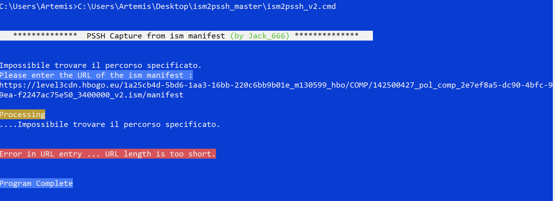

Hello, I tried using the script on a test URL from the first post but I get "Error in URL entry ... URL length is too short.".
What am I missing? other URLs get the same error.
[Attachment 70985 - Click to enlarge] -
Hi Filippo and thank you for your query
You have two challenges with respect to your quest.
1) The root cause of your first challenge is that you do have not created the two required sub directories .... re the readme
(In same directory create two subdirectories called tmp and pssh )
2) The second challenge is that the test link no longer exists.
Error in URL entry ... URL is not available on server. -

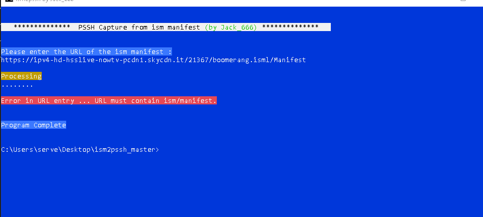

hello communith thanks for best materials shared.
i have one problem i used last version v2 but no work with this isml: https://ipv4-hd-hsslive-nowtv-pcdn1.skycdn.it/21367/boomerang.isml/Manifest
[Attachment 76884 - Click to enlarge] -
