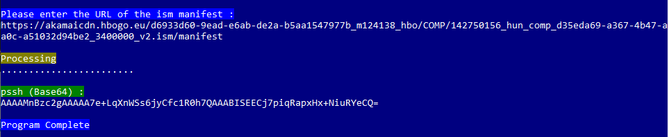

    I ran the script against your url and got the same pssh as you said was correct to best knowledge
    [Attachment 62281 - Click to enlarge]
    Have no idea what you are trying to say
    you also wrote
    It's as if it's a shorter pssh than usual, missing a few characters.
    ??????????? care to explain?
  16. Originally Posted by jack_666 View Post
    Originally Posted by neo81 View Post
    Hi!
    https://akamaicdn.hbogo.eu/d6933d60-9ead-e6ab-de2a-b5aa1547977b_m124138_hbo/COMP/142750156_hun_comp_d35eda69-a367-4b47-aa0c-a51032d94be2_3400000_v2.ism/manifest
    To the best of my knowledge, this is pssh:
    AAAAMnBzc2gAAAAA7e+LqXnWSs6jyCfc1R0h7QAAABISEECj7piqRapxHx+NiuRYeCQ=
    Anyway, how to read KID and KEY from pssh?
    Thanks!
    hbogo pssh contains 76 characters but this is for all manifest
    always gives a pssh of 68 characters, which is why I wrote that it is shorter than the usual hbo pssh
    another question, how do you get the correct kid:key with this shorter pssh with another program?
    I now understand what you are saying. This pssh is derived from the kid that is stored in the manifest and also in the init.mp4
    Kindly send a pssh that is 76 characters so that we can analyze it. Thanks
    what you wrote here is kind of confusing as what you claim to be the pssh to the best of you knowledge is the same as the script produces and it is 68 characters not 76
    this is what you wrote and what i find confusing.
    AAAAMnBzc2gAAAAA7e+LqXnWSs6jyCfc1R0h7QAAABISEECj7p iqRapxHx+NiuRYeCQ=
  18. Originally Posted by jack_666 View Post
    Maybe the site's code truncated it (?)
    What do I need to do to get KID and KEY from this?

    Hello pssh character too much. What should I do in this situation? Can you help me get no results with the script you provided?
    AAACZnBzc2gAAAAAmgTweZhAQoarkuZb4IhflQAAAkZGAgAAAQABADwCPABXAFIATQBIAEUAQQBEAEUAUgAgAHgAbQBsAG4AcwA9ACIAaAB0AHQAcAA6AC8ALwBzAGMAaABlAG0AYQBzAC4AbQBpAGMAcgBvAHMAbwBmAHQALgBjAG8AbQAvAEQAUgBNAC8AMgAwADAANwAvADAAMwAvAFAAbABhAHkAUgBlAGEAZAB5AEgAZQBhAGQAZQByACIAIAB2AGUAcgBzAGkAbwBuAD0AIgA0AC4AMAAuADAALgAwACIAPgA8AEQAQQBUAEEAPgA8AFAAUgBPAFQARQBDAFQASQBOAEYATwA+ADwASwBFAFkATABFAE4APgAxADYAPAAvAEsARQBZAEwARQBOAD4APABBAEwARwBJAEQAPgBBAEUAUwBDAFQAUgA8AC8AQQBMAEcASQBEAD4APAAvAFAAUgBPAFQARQBDAFQASQBOAEYATwA+ADwASwBJAEQAPgB4AGkAVgA4AEoARQA5AFEAYQAwAE8AZwB4ADkAcgByAHAAUwAzAGoAaQBnAD0APQA8AC8ASwBJAEQAPgA8AEwAQQBfAFUAUgBMAD4AaAB0AHQAcAA6AC8ALwBkAHIAbQAuAGUAcgBjAGQAbgAuAGMAbwBtAC8AZQB4AHgAZQBuAC8AcAByAC8AcgBpAGcAaAB0AHMAbQBhAG4AYQBnAGUAcgAuAGEAcwBtAHgAPAAvAEwAQQBfAFUAUgBMAD4APAAvAEQAQQBUAEEAPgA8AC8AVwBSAE0ASABFAEEARABFAFIAPgAAAAA0cHNzaAAAAADt74upedZKzqPIJ9zVHSHtAAAAFAgBEhAkfCXGUE9Da6DH2uulLeOK
  29. @WelleTy .. what you have done is copying and pasting the actual ProtectionHeader into the script. Please copy the actual url and paste the url into the script. The script will get the pssh for you.
  30. Originally Posted by Brook_Benton View Post
    you say real url but I paste mpd link how else will it be a link
