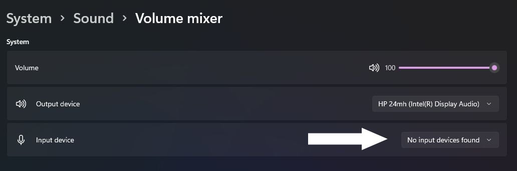

    In Windows, Open the Volume Mixer settings, make sure your "Input Device" is set to your capture dongle and not a webcam etc.
    [Attachment 62878 - Click to enlarge]

  18. I did all that already. Tried two computers and they both set the USB capture device as the default input when it's plugged in. I'm wondering if I got a dud. I have another computer I can try it on before sending it back and trying a different one.
    Aug 2006

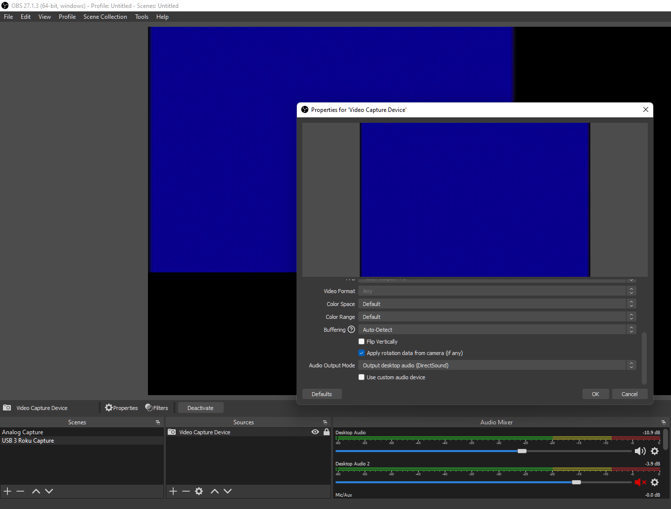

    This is how I have OBS setup
    [Attachment 62886 - Click to enlarge]
