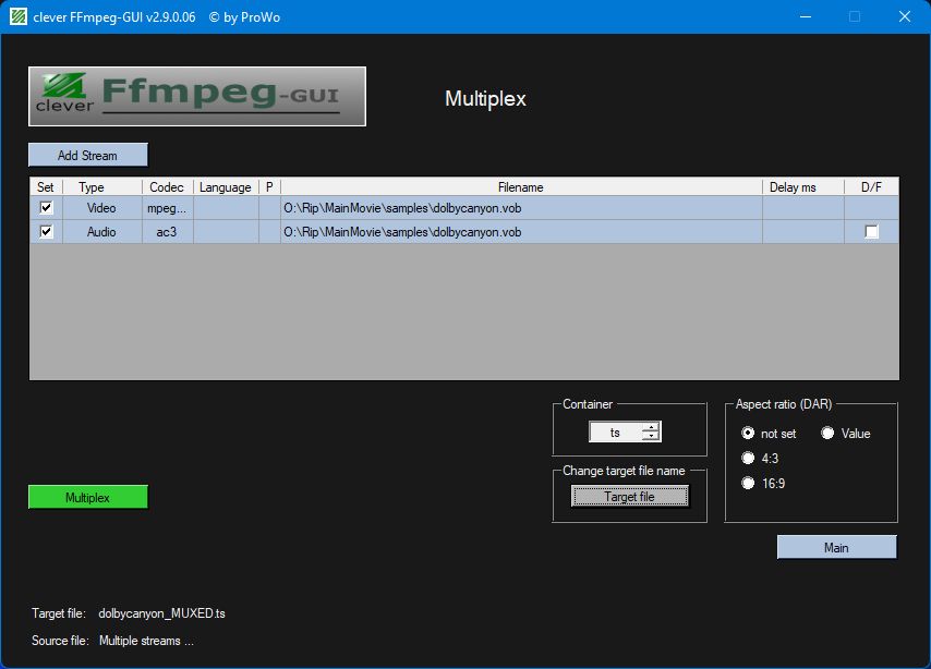

  16. @OP
    You could try clever FFmpeg-GUI.
    Load your first vob, click main, click multiplex, set ts as container, click multiplex.
    If done, click change source file, click source file, select your second vob. Then multiplex it to ts container like above.

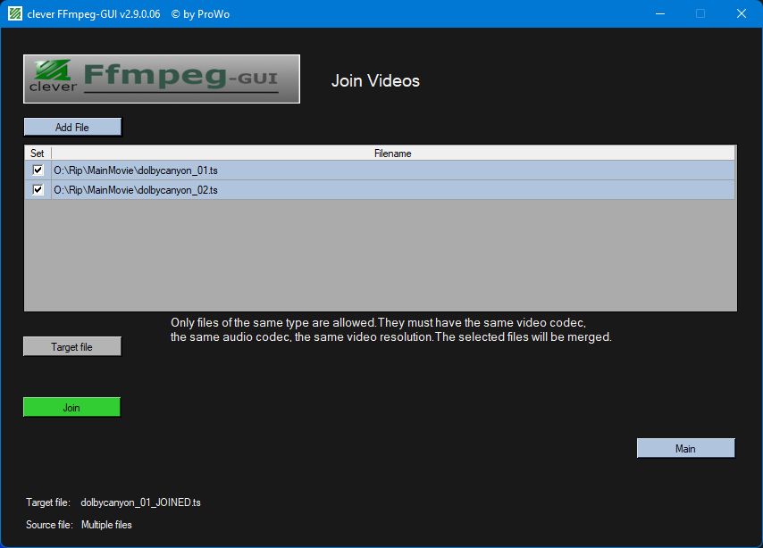

    If done, click change source file, click source file, select the first converted ts file.
    Click add file and add the second converted ts.
    Then click join.
    Done.
