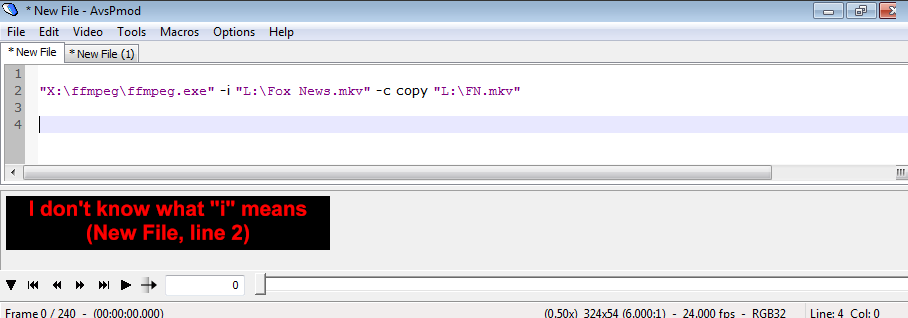

  10. Screenshot attached:
    [Attachment 62279 - Click to enlarge]
    What am I doing wrong? I tried this with an AVC clip as well and got the same problem.

  12. You can't run ffmpeg in Avspmod. Run it from the command prompt.
  13. VideoFanatic - jagabo gave you a command line for command prompt window to prep your file for avisynth script, it is not a line meant for avisynth script.
    ... too late

    I don't think AVSpmod can execute such a command line. It opens AVS scripts directly.
    Issue such a command from the native command prompt
