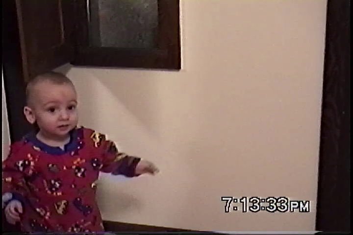

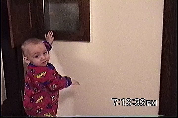

  8. I'm having a similar issue I think, I'm trying to convert Hi8 tapes to digital but I'm playing it back on a Hi8 camcorder, a Sony CCD-TRV68. I had just cleaned the heads before playing back this tape, so it's not dirty heads. S-Video looks much crisper, much more detailed (as it should) but it has much more grain than composite. Attached is a screenshot from each. Is there any way to fix this, like maybe it's a bad cable? I don't have another S-Video to test it on, so that could be it.
    S-Video:
    [Attachment 62531 - Click to enlarge]
    Composite:
    [Attachment 62532 - Click to enlarge]

    Composite is just washing out the details therefore hiding grains, It is not better than S-Video by any stretch. The grains are due to low light conditions from a low resolution imaging sensor, it has nothing to do with the format itself, Take a clean digital video and record it to a Hi8 camcorder equiped with VCR mode and see how it looks.
  10. The s-video cap is closer to what's on the tape. If your capture device has a sharpness setting turn it down. All it does is increase the noise with low res consumer recordings. Same for the camera. Your images show a lot of DCT ringing and blocking artifacts. Don't use lossy compression codecs while capturing. Use lossless instead. You can reduce noise and compress later.
