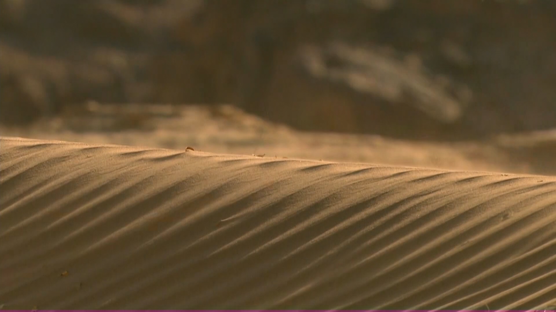

In first 1.2s of video there is a pink bar on the bottom.
[Attachment 62175 - Click to enlarge]
If this would be a picture, removing it is faster than launching Photoshop, but how about video?

Using EdgeFixer on the affected frames using Avisynth or Vapoursynth should work fine.

I just run this Avisynth with EdgeFixer. Checked sample and created script. Then run it. In MPC-HC won't working, in WMP talking can't open file. I tried full path and file name only - both don't working. Script in ANSI. Video in TS, both players can load it throgh explorer. Don't know WTF
Ok, now know, script must be instructed about format. But it still don't working in MPC-HC.
Also it's not real solution, video is not fixed.Last edited by JosephTocco; 6th Dec 2021 at 04:01.
ImageSource("Secrets of The Desert Elephants.ts_snapshot_00.00.247.jpg", start=0, end=240, fps=23.976) ConvertToYV12() patch = ChromaShiftSP(x=20, y=-10) patch = Overlay(patch, last.Crop(0,0,0,-10)) ReplaceFramesSimple(last, patch, Mappings="[0 29]") # first 1.2 seconds

http://avisynth.nl/index.php?title=RemapFramesLast edited by jagabo; 6th Dec 2021 at 17:49.
You need to re-encode the video after applying the filter.
open the avisynth script in virtualdub2, preview it does what you want, then save the output video. -
Here's one that doesn't require any third party filters (aside from the source filter):
Code:source = ImageSource("Secrets of The Desert Elephants.ts_snapshot_00.00.247.jpg", start=0, end=240, fps=23.976) source = source.ConvertToYV12() bottom = Crop(source, 0,source.height-10,-0,-0) # the last 10 scan lines above = Crop(source, 0,source.height-20,-0,10) # the ten scan lines just above that bottom = MergeChroma(bottom, above) # replace chroma of the bottom 10 with the chroma of those just above fixed = Overlay(source, bottom, x=0, y=source.height-10) # put the fixed chroma over the original vieo fixed.Trim(0,29)++source.Trim(30,0) # first 30 frames fixed, rest as is -
