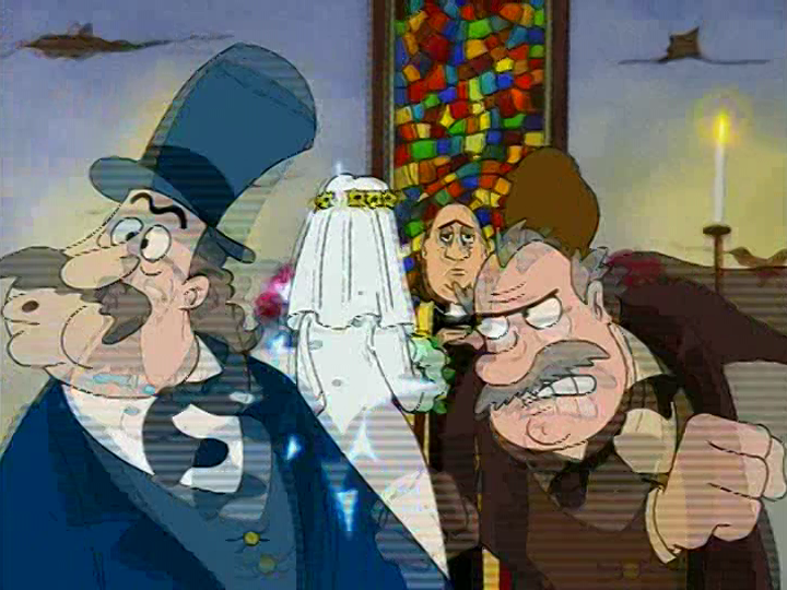

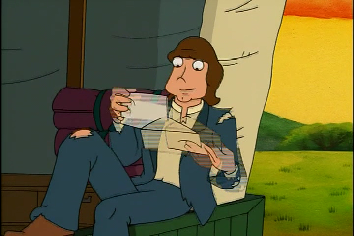

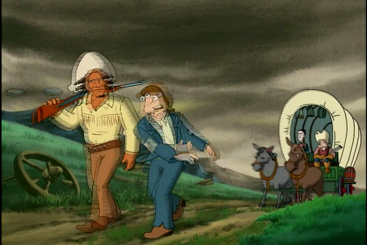

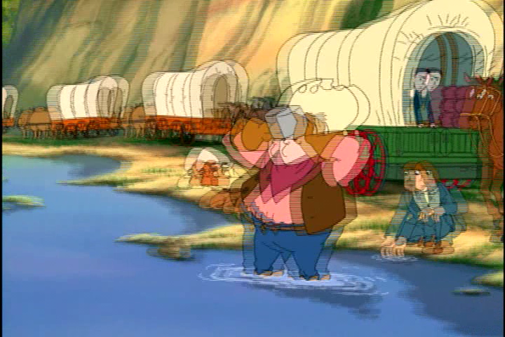

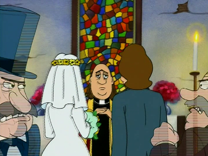

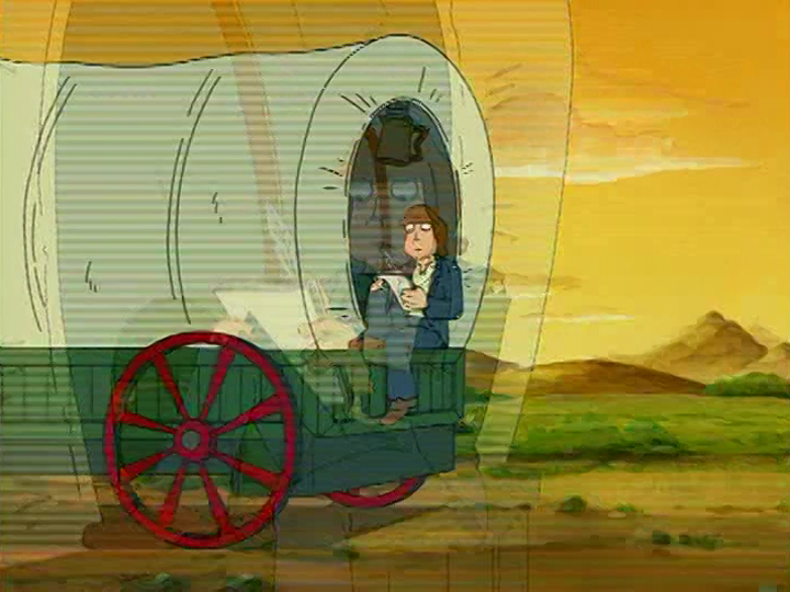

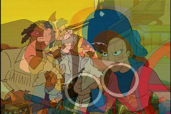

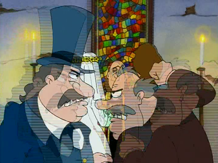

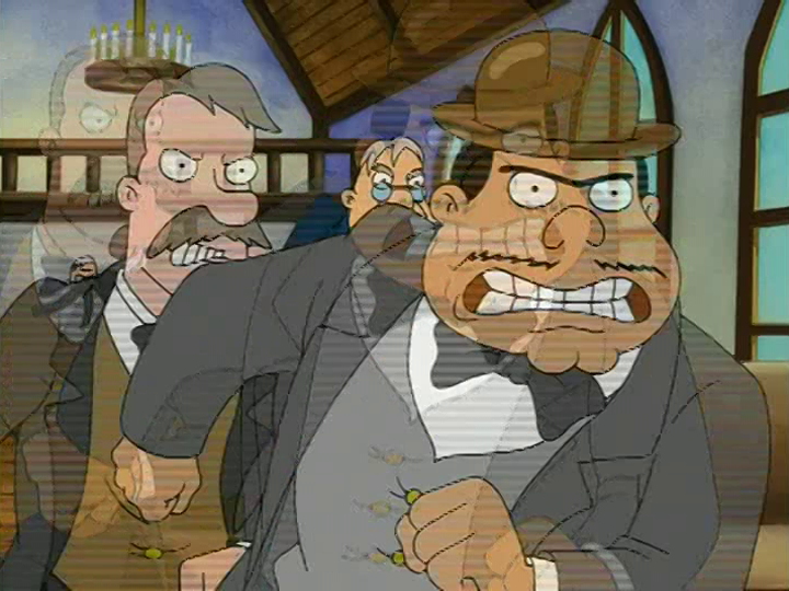

Here are some screen shots of the DVD without any scripting/resizing @ 720x480. - I've taken the raw MKV file, dropped it into VirtualDub and exported the frames as they normally would be.
EDIT: I prepared another sample but I couldn't upload it to the forum due to their 500mb limit. So I uploaded it to my Google Drive instead. These are the untouched frames of the same sequence. They are interlaced and I haven't messed with the size, but as you can see the problem still persists.
EDIT EDIT: I've been told I should provide a demuxed sample of the DVD. You can find this attached below. In the .rar you will find the M2V, D2V and the AC3 file.Code:https://drive.google.com/file/d/1bmJS4bmFoI8jJTai3t4knOl3-FC7to7y/view?usp=sharing

The video is interlaced top field first, but is encoded progressive bottom field first -- causing the chroma of the two fields to blend together. It was improperly resized while interlaced causing the two fields to commingle. And it was frame rate converted with field blending. I recommend you look for a better source.
