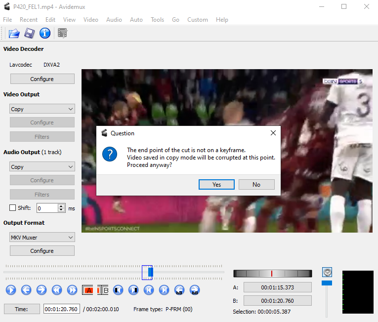

Hello,
Thanks for your reply, I tried to use the software, but I don't know if I am doing the job right, please advise!
By the way, can I use the software in DOS command in Windows 10?
[Attachment 62123 - Click to enlarge] -
for (no re-encode) copy operation:
delete end must be a keyframe (I-FRM)
use >> button or Up key to navigate keyframes. The example video has keyframes every 2s.
the saved video should play without corruption or freeze.
Typically visualizing the frame you are cutting at is beneficial, which isn't possible via command line.
You probably should explain more in detail what problem you are trying to solve. -
The sample video clip has only I and P frames. Any segment you keep must start on an I frame but it can end on any frame. The bad frame in that video is just a few frames before the end of the GOP. The bad frame is a P frame, the next frame is another P frame, and the next an I frame. So you can cut out just those two P frames.
