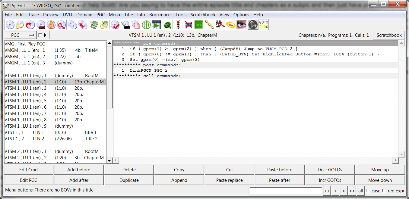

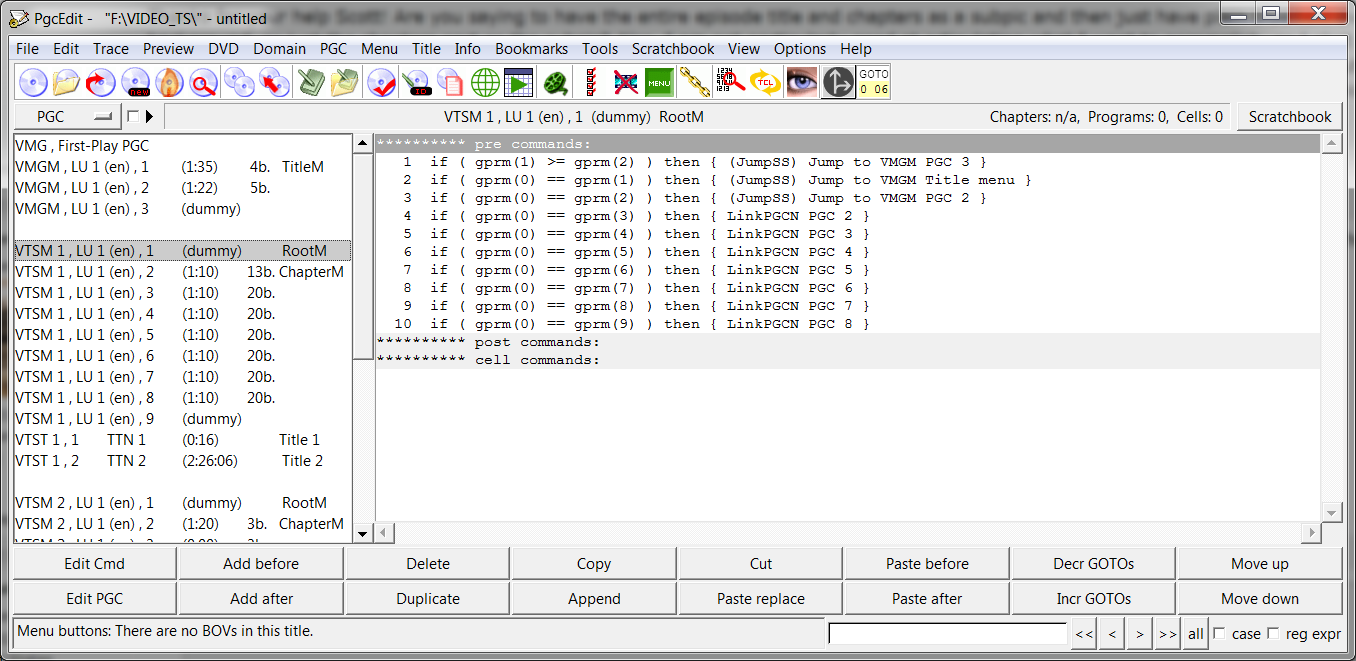

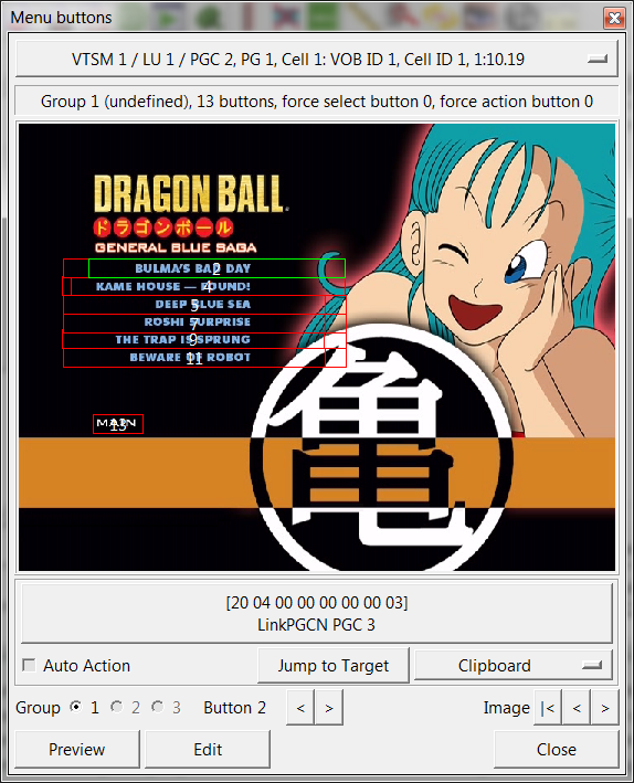

    Holy Cow, PCGEdit is AMAZING. I will be donating to that guy for sure..... I am JUST barely learning how to use PGCEdit so bear with me, but I think I got what you asked for. I am no expert, but it definitely LOOKS like overlapping buttons. This dvd isn't the same exact one from my dvd player, but another one in the series authored by the same company, with the same exact look and feel (it has this same episode/chapters feature I want). I don't see the subpicture in PGCEdit when I did cntrl + m, but I am guessing that is to be expected. Anyway, here are the screen captures:
    [Attachment 62106 - Click to enlarge]
    [Attachment 62107 - Click to enlarge]
    [Attachment 62108 - Click to enlarge]
    Not sure if it will help, but here are some VM commands from the menu
    [Attachment 62109 - Click to enlarge]
    [Attachment 62110 - Click to enlarge]
  17. Member Skiller's Avatar
    Oct 2013
    Germany
    Fantastic.
    Like I was suspecting, it does look like the buttons are overlapping but to make absolutely sure you would click on "Edit" and check if the X-Position and Width of two buttons that are on the same row indicate overlapping.

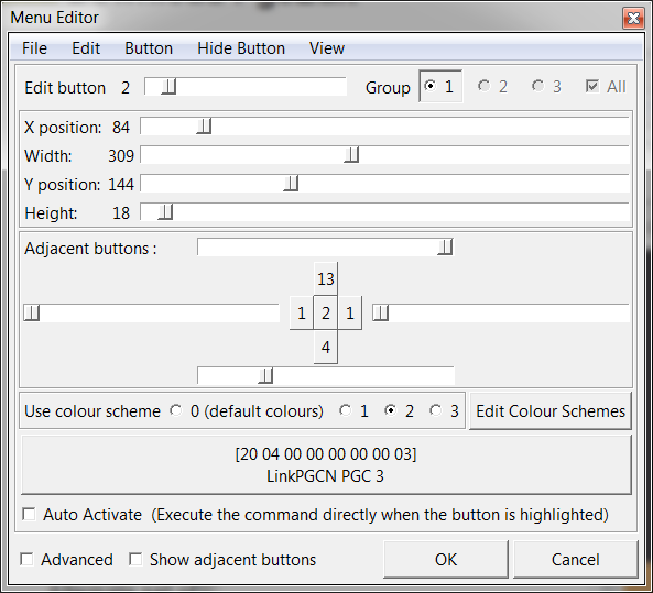

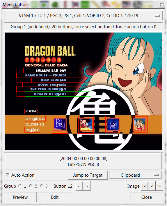

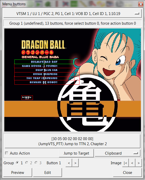

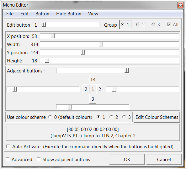

    Here you go. It sure does look like overlap to me (which I thought was illegal, especially with all the warnings in DVDLab Pro).
    [Attachment 62111 - Click to enlarge]
    [Attachment 62112 - Click to enlarge]
  20. Member Skiller's Avatar
    Oct 2013
    Germany
    It's confirmed – the buttons are overlapping! Awesome!!! I'm stunned!
    Button 1 and 2 are overlapping by a whopping 283 pixels!
    I can't believe I just learnt something new after ~15 years of authoring, some of which were really complex discs. I did not think this is even possible without breaking the menus.
    It is, it's a hack, but it works perfectly as demonstrated by that Dragonball DVD.
    You don't need Scenarist to pull this off – just use PgcEdit after authoring to overlap the buttons you prepared in DVDLab. Easy.

    The casual viewer presses the down key + enter once for title 2 without paying attention to the fact that the selection is actually the chapters for title one and could be mighty cheddared to realise that he did not get what he thought he was getting.
    ...you just disable all arrow keys except left for the chapter buttons. Or make down jump to the episode button diagonally below (probably best). It's easily done after authoring using PgcEdit. I check it all the time because authoring softwares sometimes make stupid navigation decisions.
  28. Member
    Dec 2021
    Originally Posted by Skiller View Post
    I don't think the rectangle area plays a role in what action to take if you press OK because no matter the rectangle the buttons are still numbered and assigned to their designated code as usual. Navigating between buttons is also coded and not tied to the actual size and position on screen. You can actually see that in the last two screenshots; you can edit which button to jump to if the user pushes which of the four directional buttons. Afaik the rectangle is needed just for revealing the underlaying subpic.
    The overlap is going to produce weird results when navigating such menu on a PC using the mouse, that's for sure.
    But it is pretty cool and I will try it.
    Did you ever get a chance to replicate the functionality with overlapping buttons? I tried and am getting weird results, not what I want. Do you use the "text" object and attach links to it, or just have text with no links and draw rectangles and add links to those?
  29. .... never mind, sorry
  30. Member
    Dec 2021
    I understood what you were saying. If I intended to distribute this DVD for others, I would probably go a more conventional route. I am making it for me. For this particular series, there are 11 Sagas. Only 2-11 were ever released to the US due to distribution rights. Only Australia got all 11. So I bought Saga 1 from Australia. To my dismay, the menu was completely different (different authoring company). So for THIS PARTICULAR Dvd, I am trying to emulate the same exact look and feel of the menus, chapter points, chapter playlists, etc from the American NTSC version so it will be consistent with my existing collection of sagas 2-11. I have already ripped all of the video/audio/subtitle streams etc. I used TMPGEnc to encode a deinterlaced video with 720x480 resolution, but still playing at 25 FPS. Then used a program called DGPulldown to convert 25 FPS to 29.97 FPS. I realize that the project isn't perfect, as reencoding always loses quality in MPEG2 and the DVD structure is weird (but consistent with my existing collection). I even plan to burn it with an inkjet printable dual layer DVD so I can have the same design. I also made a corresponding photoshop project for the dvd case cover consistent with the collection. Obviously having a purple playing surface means it won't look like a professional dvd, but it is what it is. I'm not ignoring what people are saying regarding best practices, just trying to do something apparently unconventional in this particular case. I do appreciate your input.
