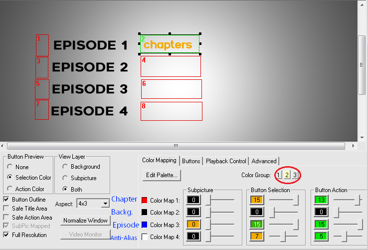

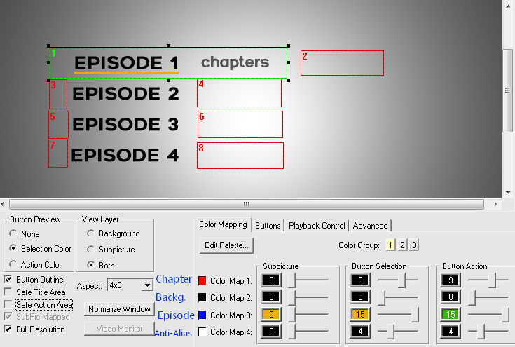

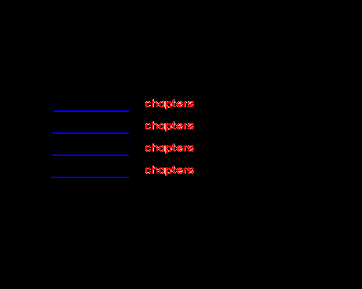

    I would gladly help if you need it because I like your project. And the fact that this is finally something more elaborate than the usual "how do I put this mkv on DVD" questions.
    Here are some screenshots that may help you recreating this in DVDLab. I use DVDMaestro (which is ancient but you know, once you know how to use a tool you keep using that tool) and I suppose these things should be pretty similar in DVDLab.
    This is the actual subpic BMP I made and indexed in Photoshop:
    [Attachment 62163 - Click to enlarge]
    So as you know we have 4 colors we can use. I used the colors this way:
    1) Red: Chapter text
    2) Black: Background
    3) Blue: Episode highlighter (underline)
    4) White: Chapter text anti-alias
    You have to decide if you want to spend the anti-alias color for the chapter or episode. In my case I chose an underline so I didn't need the anti-alias there and used it for the chapter text.
    Episode button:
    [Attachment 62164 - Click to enlarge]
    Chapters button:
    [Attachment 62165 - Click to enlarge]
