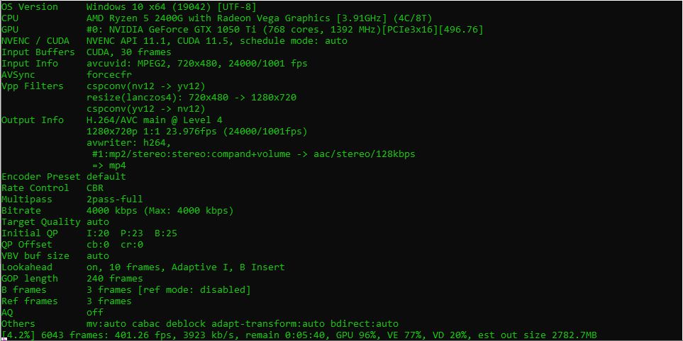

    Here is 400+ fps encode with Nvidia GPU (GTX 1050ti) and NVENC Vs. 70 fps with CPU and NVENC
    [Attachment 62116 - Click to enlarge]

    BTW, here is my NVENC string for progessive source:
    nvencc64 --avhw -i "%%~na.mpg" --avsync forcecfr --fps 23.976 --profile main --level 4 --dar 16:9 --multipass 2pass-full --cbr 4000K --codec h264 --lookahead 10 --audio-codec aac --audio-stream :stereo --audio-filter "compand=.3|.3:1|1:-90/-60|-60/-40|-40/-30|-20/-20:6:0:-90:0.2,volume=3" --audio-bitrate 128 --vpp-resize lanczos4 --output-res 1280:720 -o "%%~na (720).mp4"
    [Attachment 62120 - Click to enlarge]
