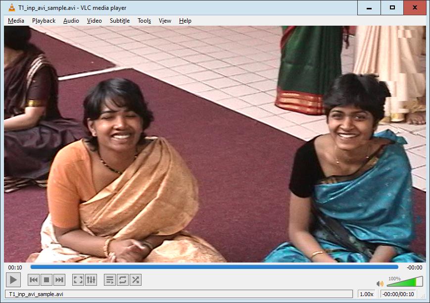

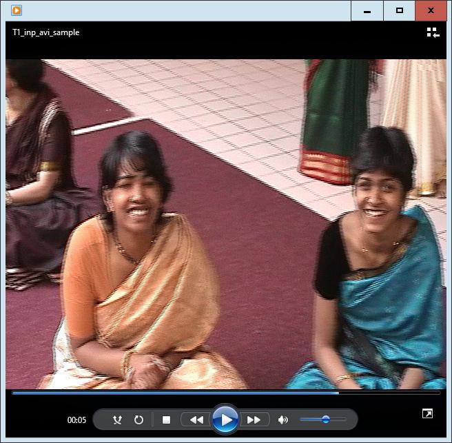

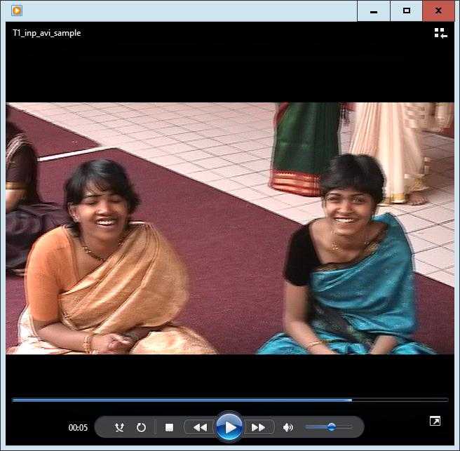

  17. It looks like there are errors in the DV stream. The errors are causing Windows Media Player to play the video incorrectly towards the end of the clip -- with the frame size flickering back and forth between 16:9 and 4:3.
    [Attachment 62187 - Click to enlarge]
    [Attachment 62188 - Click to enlarge]

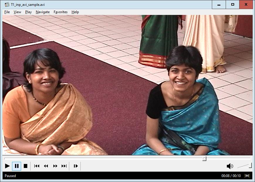

    I'm guessing this is the flickering you are talking about. Other players I tried did not show that flickering -- they just played the video as 16:9:
    [Attachment 62189 - Click to enlarge]
    There were some visible decoding errors in the other players though. Note the displaced blocks at the right of the frame, near the girls head:
    [Attachment 62190 - Click to enlarge]
    The errors could be caused by the firewire transfer from camcorder to the computer (though I think this unlikely), the reading of the tape, or they could be on the tape itself. Try cleaning the tape heads. If you get exactly the same errors every time you capture that sequence the errors are on the tape (not unusual for DV). If you have access to another DV camcorder you could try using that.
