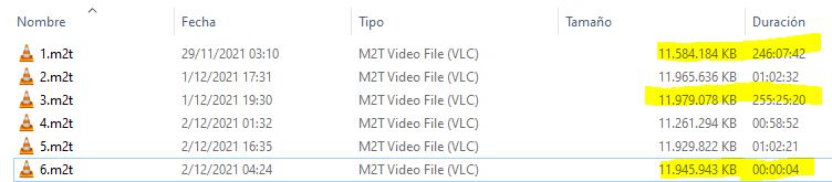

But the weird thing is that there are other only HDVs that I transfer with HDVSplit, 1 hour cassette but I get an 11gb file with supposed 4 seconds of duration, but that when playing it and ending the 4 seconds the video continues correctly as corresponds to the original 1 hour video, that is to say that it does not last 4 seconds but 1 hour as it should be. But for some reason the transferred video file comes with that error. The information exist and it shows in the weight of 11gb, in addition to that when reproducing it you can see it. But the archive its corrupt.
I don't understand what may be causing this error. I am forced to replay the tape and it is a lottery whether I get a good file or not.
[Attachment 62121 - Click to enlarge] -

I tried what you told me but I still get files with errors.
I am using Adobe Premiere Pro 2021 and I already have 10 Cassettes with no problem when capturing. It requires more PC resources but is more secure.
