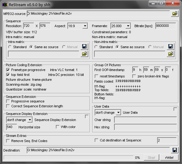

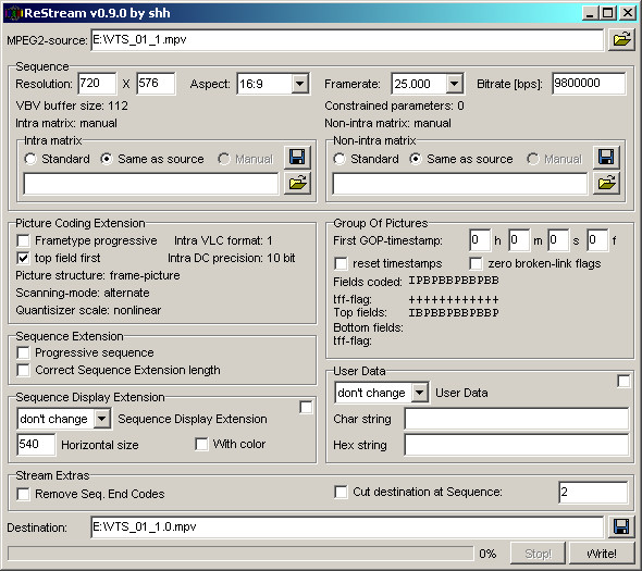

  22. Member Skiller's Avatar
    Oct 2013
    Germany
    Pretty much, but more precisely, most of the time commercial PAL DVDs with progressive content are encoded like this:
    Scan Type: Zig Zag
    Frametype progressive flag: yes
    Top Field First flag: yes
    Progressive Sequence flag: no
    For example, this is the demuxed video stream of the German PAL DVD "The Hunger Games: Mockingjay Part 2":
    [Attachment 62087 - Click to enlarge]
    We can see that the actual encoding used Zig Zag scanning which is optimal for progressive content. So there's no loss of efficiency in encoding, it's just that the flags are set in a rather conservative manner.
    To flag this truly progressive we would change the flags to this:
    Frametype Progressive: yes
    Top Field First: no
    Progressive Sequence: yes
    But some people say this can cause issues on few very old players (like 2001 ish) and that's probably why it's not used. I've never had any issues with this. In fact it makes progressive scan players completely disable any of their deinterlacing attempts, which is ideal.
  23. Originally Posted by Skiller View Post
    Scan Type: Zig Zag
    I won't argue yet because it's not something I've looked at much, but I still had a ripped DVD on my hard drive. It's an Australian TV series filmed in 2016. (Xanthipos, I'm in Melbourne too. Nice and hot suddenly, isn't it?)
    https://en.wikipedia.org/wiki/Wanted_(2016_Australian_TV_series)
    It's definitely progressive (I didn't need to de-interlace while re-encoding).

    [Attachment 62088 - Click to enlarge]
    [Attachment 62089 - Click to enlarge]
