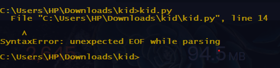

What Python script?
Just copy that code in Notepad, save it as kid.py, make sure you have Python installed and just open cmd in the folder where kid.py is and type kid.py and press enter.
Anyways, you are better off using this EME thing, because sometimes the Python script I posted won't be of use. It requires for you to download the init and sometimes that's not possible. -
Regarding generating the pssh, I also prefer to try various ways manually. Indeed, EME Logger works very well.
On the other hand, when I run kid.py, as shown in the screenshot, I get the following message:
[Attachment 62250 - Click to enlarge]
Thank you for your help! -
