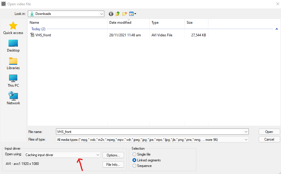

  23. Image
    [Attachment 62052 - Click to enlarge]
    VirtualDub2, simple file open. Didn't adjust input filters or anything.
    Maybe adjust this:
    [Attachment 62053 - Click to enlarge]

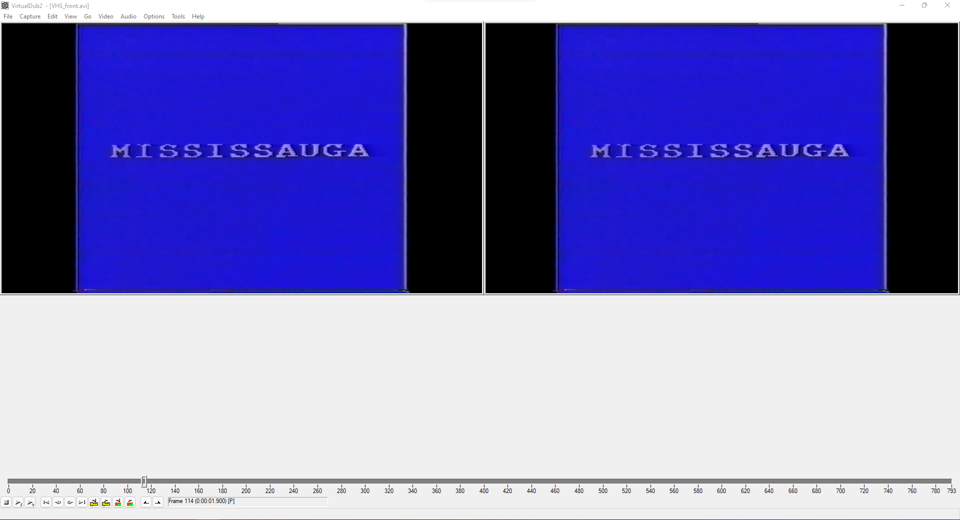

    Make sure the input pane is enabled on the View menu.
    Originally Posted by satimis View Post
    How to check ffmpeg is properly installed on Win10 and running correctly ?
    Apparently it's listed in the pulldown and you didn't get an error message when you opened the file so the ffmpeg source filter is working. But it's in VirtualDub2's plugins32 and plugins64 folder as avlib-1.vdplugin.
    Maybe adjust this:
    Same as yours. Pls see attached screenshot
    - snip
    Which input pane ?
  27. Member
    Mar 2008
    At the top - View/ enable input/output pane

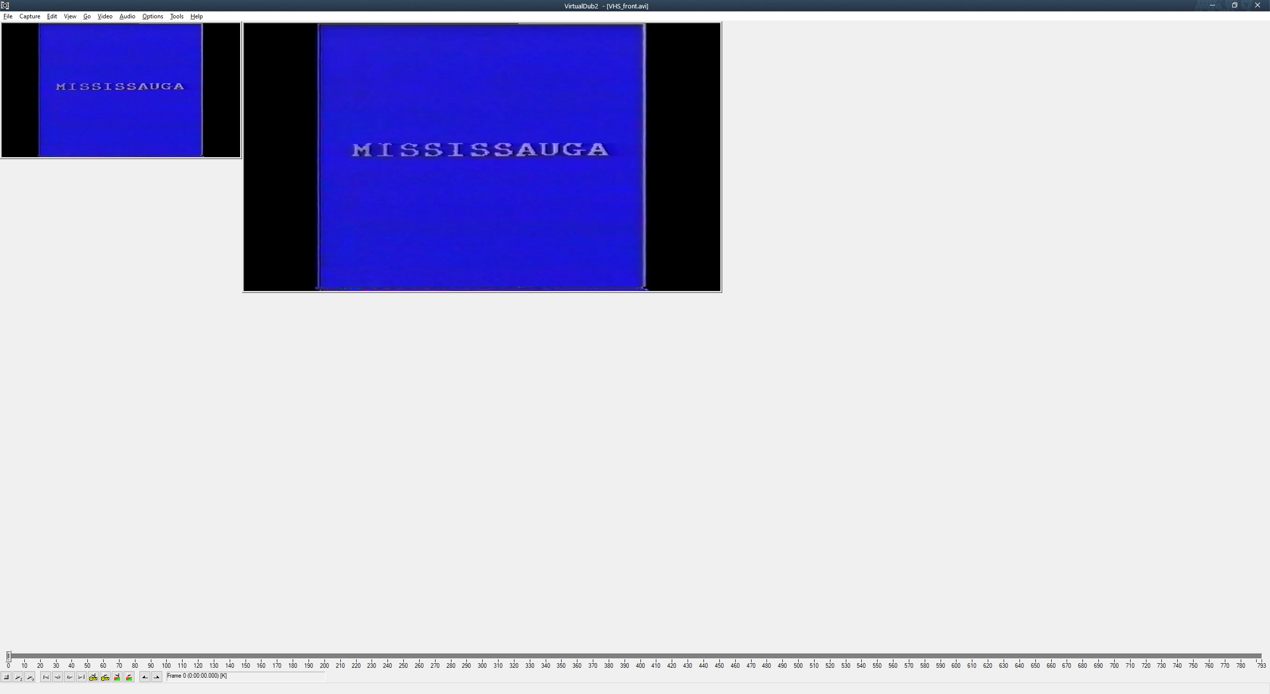

  28. Member
    Aug 2014
    Hong Kong
    -> View -> Pane layout
    select;
    Both panes
    Pan & zoom: Center
