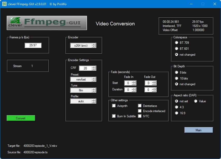

Then load this TS file into clever FFmpeg-GUI, click main, click Convert Video Stream, if you don't want to crop or resize, click continue, choose encoder settings like on the picture, leave everything else as it is, click convert. There is no need to do an two pass encode.
[Attachment 62057 - Click to enlarge]

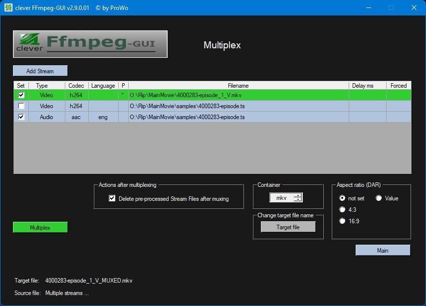

When it's done, click multiplex, the newly created video track is displayed in green, all tracks except the old video track are already selected, select the container (mkv, mp4), click multiplex.
[Attachment 62058 - Click to enlarge]
Done.
