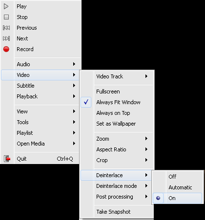

  13. Member Skiller's Avatar
    Oct 2013
    Germany
    Just to make sure, Deinterlace is set to on (not automatic), right?
    [Attachment 62009 - Click to enlarge]
  14. Originally Posted by Skiller View Post
    Yes. All the possible combinations have been tried, I think.
