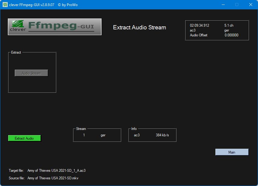

Use clever FFmpeg-GUI, load your video and after a short analysis you will see all included streams. If you still don't have enough information, click main, click extract audio stream, select stream 1, click extract audio, listen to the new created file, then extract audiostream2 and so on.
[Attachment 62007 - Click to enlarge]Last edited by ProWo; 25th Nov 2021 at 10:22.
