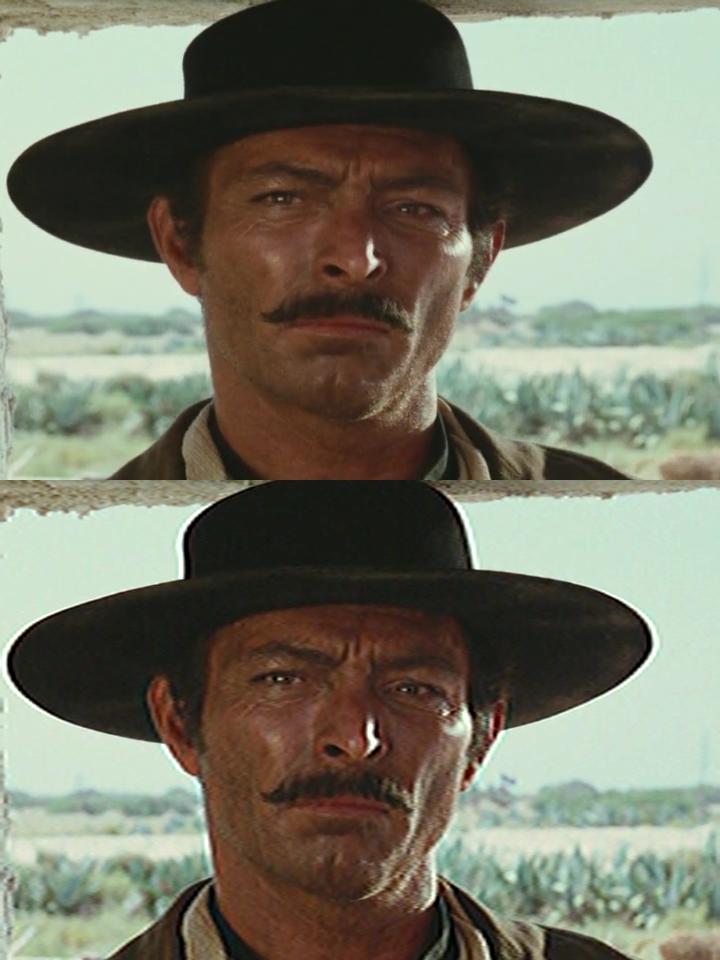

Analog video had no memory of what came before so it was done on each scanline with a simple analog sharpen filter. The amount varied from deck to deck. An easy way to simulate this in software is to downscale horizontally (to about the horizontal resolution of VHS), sharpen horizontally, then upscale horizontally. In AviSynth something like:
before/after:Code:# typical 720x480/576 source Spline36Resize(240,480).Sharpen(1.0, 0.0).Spline36Resize(720,480)
[Attachment 61963 - Click to enlarge]
Note that Sharpen(1.0, 0.0) is essentially a 1x3 sharpen. You can use a 1D unsharpmask algorithm with the correct radius to do this without resizing.
https://en.wikipedia.org/wiki/Unsharp_masking
To undo it you want to reverse that process. So downscale, blur, and upscale. Of course, you don't get back the sharpness of the video before it was recorded to VHS, just a reduction of the halo.
There are several halo reduction filters for AviSynth.Last edited by jagabo; 22nd Nov 2021 at 21:47.
