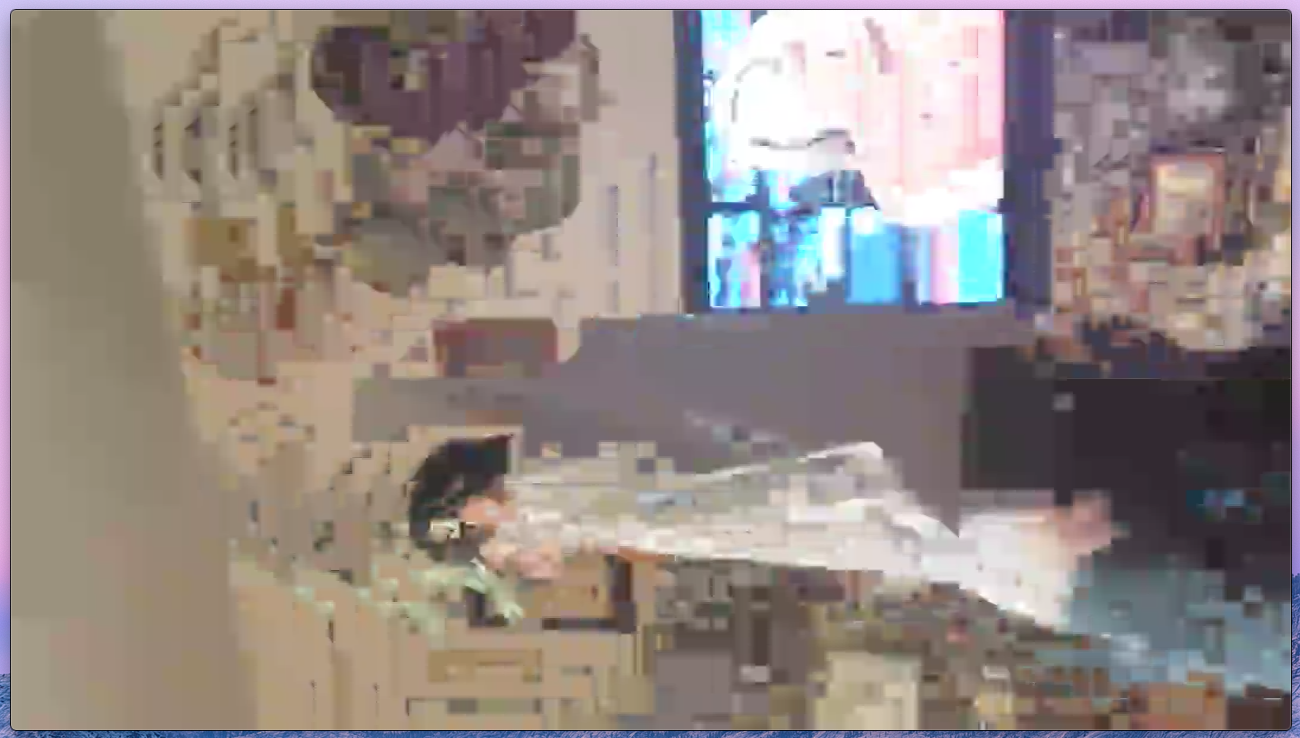

    The problem is when I convert the videos I have to match these specifications, I play back the converted video and it is VERY pixelated, the audio is playing a lot faster then the video itself and then the video cuts off a lot shorter than what the original video length plays to. I tried messing around with the frame rate and bitrate on the (AVC) software and nothing seems to change. PLEASE HELP! I feel defeated

    You won't/shouldn't get any pixellation at 1080P; even at SD (720x480/720x576).
    How are you converting them? I would have a try with Handbrake.

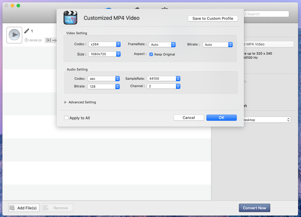

  3. I'm downloading Handbrake as we speak.... Currently, I'm using Any Video Converter. I drag the video file and choose the 'Customize MP4 Video' option and under the 'Video Setting', I'm choosing
    Codec : x264
    FrameRate : Auto
    Bitrate : Auto
    Size : 1080 x 720
    Aspect : Keep Original
    I don't touch anything under the 'Audio Settings' and 'Convert'. But all the problems arise as soon as I try to play the video after the conversion...

    Thank you so much! Just converted the same video using Handbrake and it was able to convert it to the right resolution to play it on the picture frame. The only issue I'm having now is the newly converted video cuts off about two or three seconds early. Any suggestions?? The video is 23 seconds long and the frame is capable of playing videos that last 30 seconds so I'm not too sure as to why that's happening??
    Mar 2008
    That looks like a decoding error of the source to me
  6. Originally Posted by davexnet View Post
    I agree.
