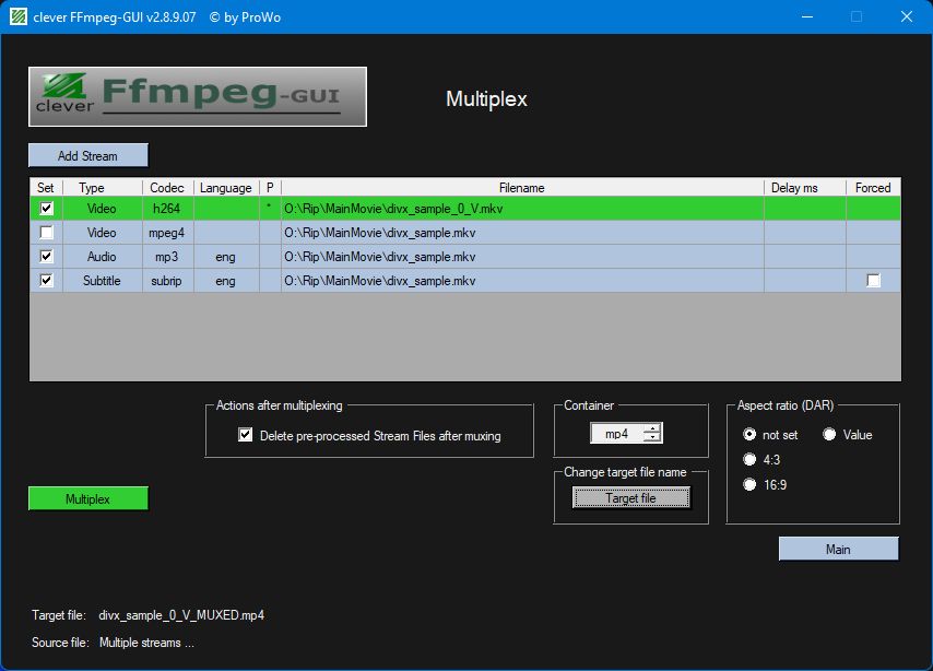

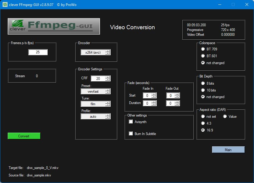

  4. Use clever FFmpeg-GUI.
    Load your divx movie, click main, click convert video stream, click continue, set all like in the picture, click convert.
    [Attachment 61828 - Click to enlarge]
    If done, click multiplex, the new avc video stream is shown in green, leave all streams checked except the old mpeg4 stream, select mp4 as container, click multiplex. Done.
    [Attachment 61829 - Click to enlarge]
