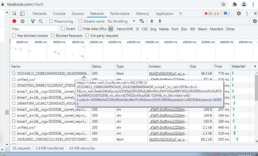

    I have some questions about how you got the video. I used Chrome network tab and found this: (See screensho). I used yt-dlp to try to download some of these entries but had no luck. Could you post exactly what you did, (also, show me what is "downloading the init").
    In the below screenshot, I tried downloading with yt-dlp the whole highlighted script, and also just the part that ends in "mp4", but had no luck. I can guess that those entries (that start with numbers) are video chunks, but I was unsuccessful to download them. Also, once you downloaded all the chunks, did you use ffmpeg to combine? Also, since your video doesn't have audio, how would I get the audio if I tried to do this myself?

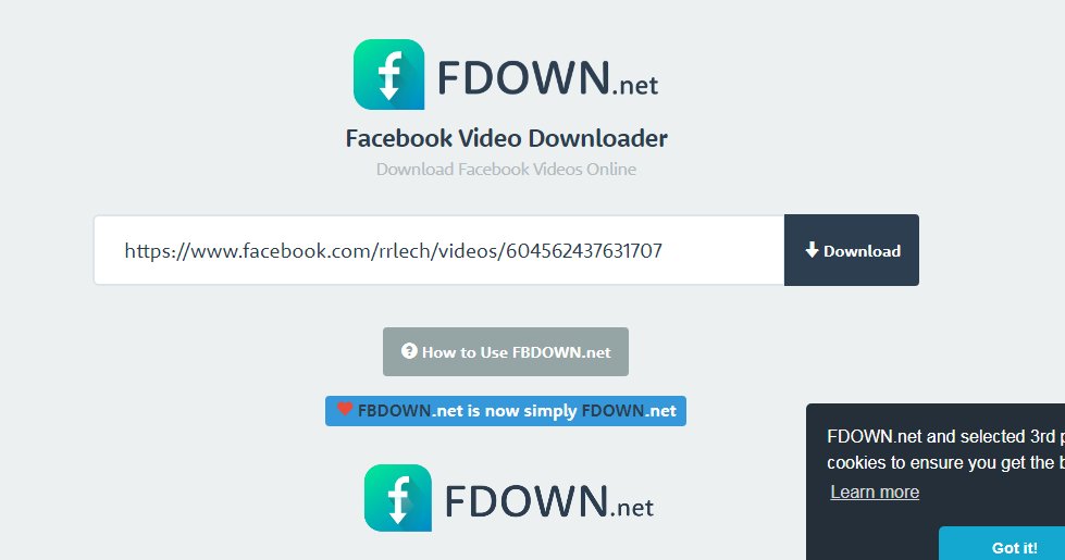

  8. or better, if you don't have IDM, we have a lot of online site that allow this.
    simply search "download video facebook"
    try this link: https://www.fdown.net/
    put video link and download it
    [Attachment 61834 - Click to enlarge]
  9. Originally Posted by lomero View Post
    That was the problem with this video, there wasn't a simple "video link" because it was in a comment.

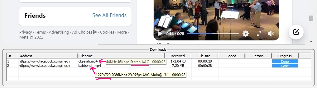

    Select highest resolution in Facebook player settings. Start to download all detected files. After some time put mouse over downloading filenames to see media information in tooltip and therefore check which file is video and which file is audio. Download these two files and rest files remove from downloading. Later join together these two downloaded audio and video files using option 'Join' in TubeDigger's converting dialog.

  12. Ok, I was able to get the 720p with audio following Mr Tubedigger's directions. Key point is to select highest resolution from gear icon in facebook video when playing the video in Tubedigger browser. Make sure the audio is sounding when playing the video in Tubedigger browser. Video and audio download separately and then easily combined with Tubedigger convert>join tool.

    I used Chrome network developer tools and played the high resolution facebook video and among lots of urls, got this (which looks similar to what you got):
    https://video-ort2-1.xx.fbcdn.net/v/t42.27313-2/242515454_208544257885778_4146127321778027725_n.mp4?_nc_cat=101&cb=3b11de2f-6a33e524&ccb=1-5&_nc_sid=5aebc0&efg=eyJ2ZW5jb2RlX3RhZyI6ImRhc2hfZ2VuM2Jhc2ljXzVzZWNnb3BfaHEyX2ZyYWdfMl92aWRlbyJ9&_nc_ohc=NAeV9JomYg0AX-LhrOM&_nc_ht=video-ort2-1.xx&oh=f743a8eaac4c4e24c9eefbb1a5bd6446&oe=619660BA&bytestart=6715599&byteend=7548488
    I put this in yt-dlp and got an error message. But I notice the beginning of my code (https://video-ort2-1.xx.fbcdn.net/) is different than your code (https://video.fskp4-2.fna.fbcdn.net/).
    Can you explain why mine is different than yours? What method did you use to get your code?
    Also, you said you used curl to download. Why did you use curl? Would your code work with yt-dlp? (I'm used to using yt-dlp.)
