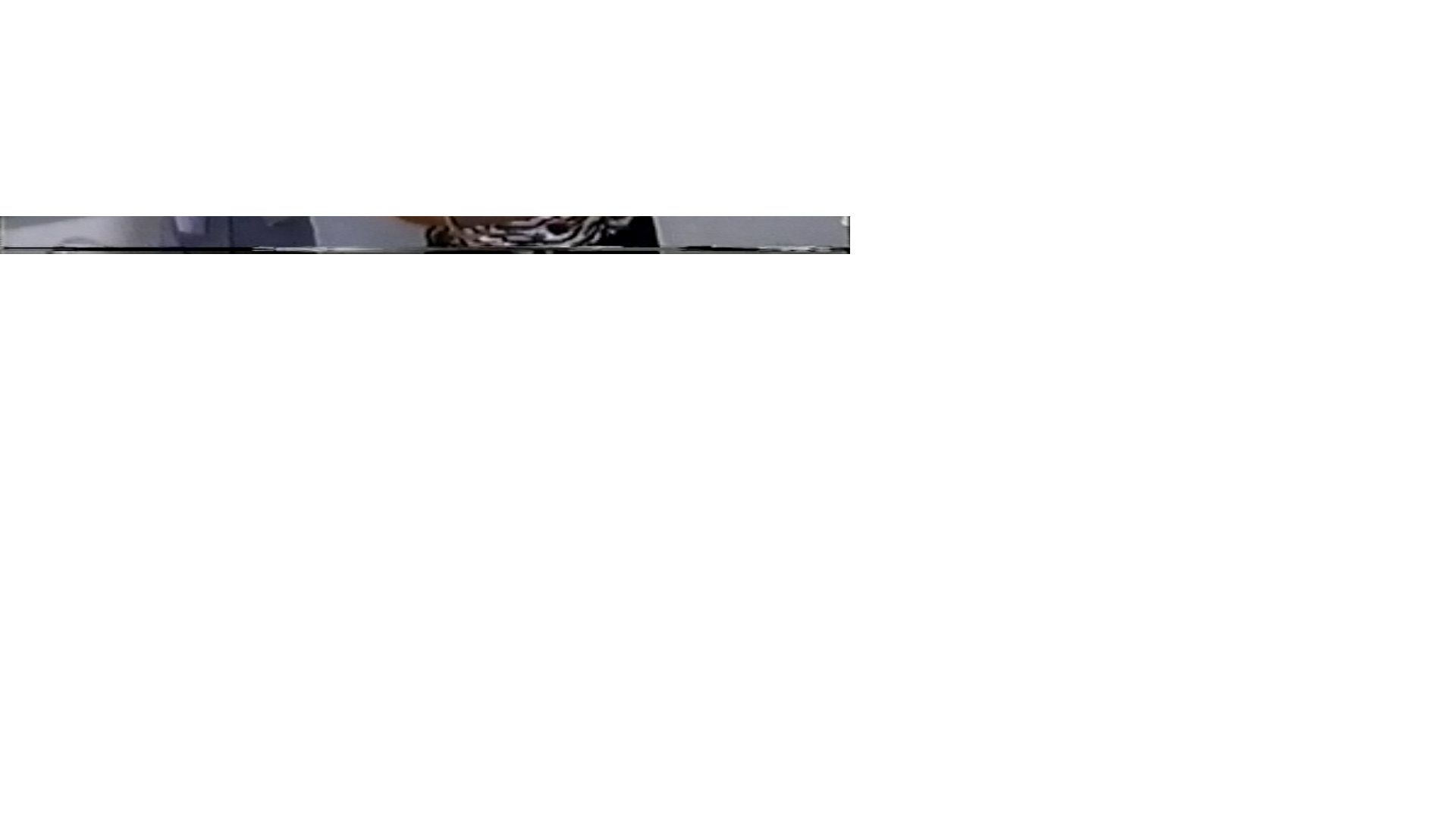

This black/grey bar appears at the bottom and top in certain parts of the video. I don't have a full frame TBC just a line TBC DVD recorder. Is there a way to get rid of this too? It appeared smaller the second time I recorded for some reason.
I notice like a flash of noise on my tape appears at moments. Could this indicate damage to the tape? Screenshot of the bar below:

It is "head switching noise", is normal to have it, and you can mask it in AviSynth withI notice like a flash of noise on my tape appears at moments.
Code:crop(0,0,0,-x) addBorders(0,0,0,x) #where x=number of lines you want to mask

Either this, or local dust/dirt on the tape, or temporary dirt on the VCR head, or a glitch in the capture. It may go away in a second capture attempt, or just appear at a different position. You may want to delete these frames using the method above (and eventually accept audio hickups and video jumps). You may just try, or upload a sample for better advice.I notice like a flash of noise on my tape appears at moments. Could this indicate damage to the tape?
