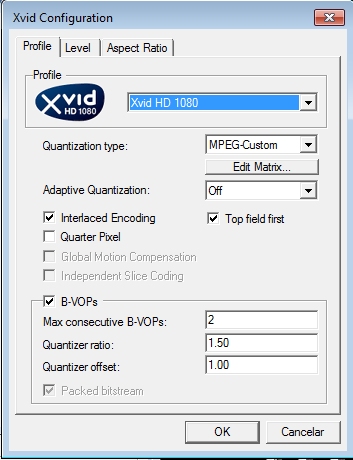

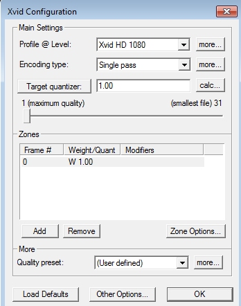

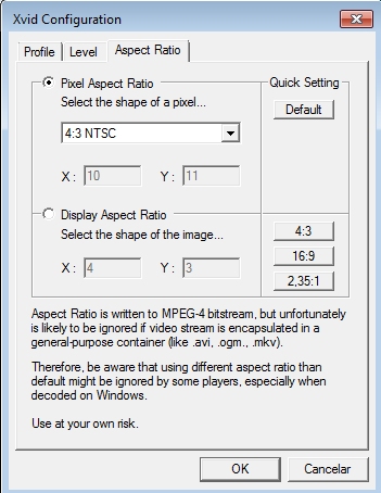

    The only problem that happens is capturing with interlaced video. I always have to edit in another program to remove it.
    Even using the setting to remove this during conversion the interlaced video keeps opening on other players, like is very visible opening the avi file on virtualdub but not on MPC Image
    [Attachment 61812 - Click to enlarge]
    [Attachment 61813 - Click to enlarge]
    [Attachment 61814 - Click to enlarge]

    Wrong tools for the job. Capture SD lossless with vdub and encode later to h.264.

    Ok... How? Help to capture with interlaced encoding right up during the convertion but it needs to open right in all media players
  4. forget xvid old codec (no interlace support). If the size matter to you try Utvideo codec which is lossless
