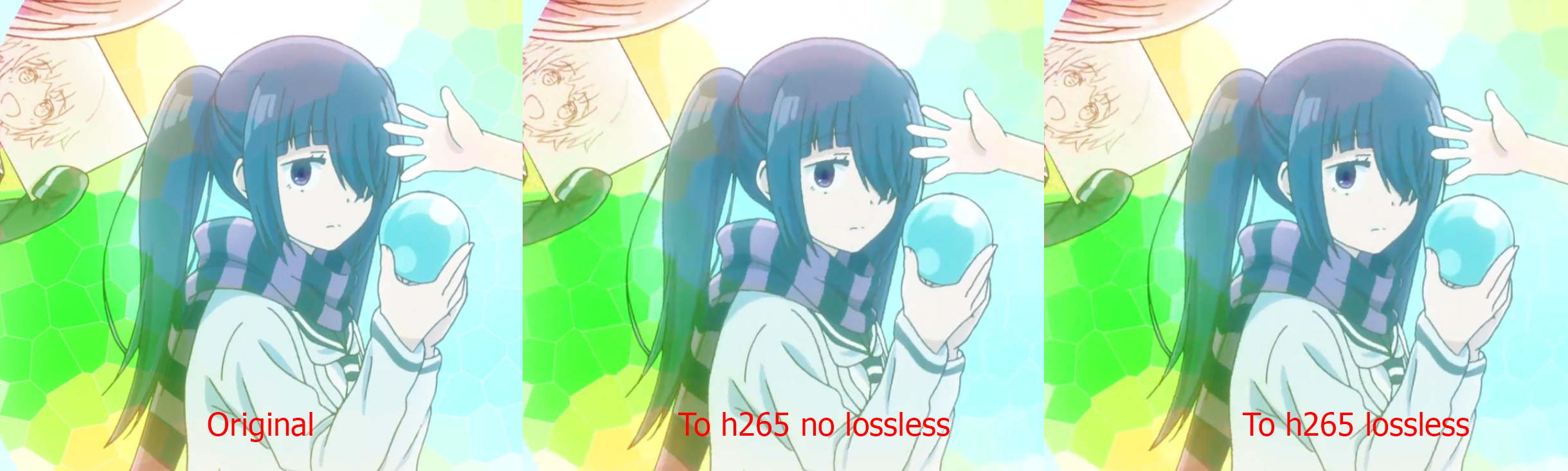

    But neither is truly lossless, check this out:

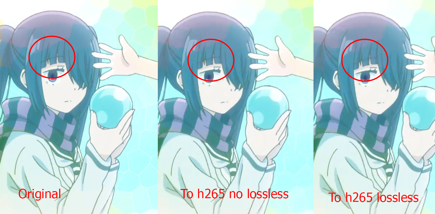

    At first sight it might look as if the h265 recode was flawless (and the size went down by 50%!) but if pay attention there IS a loss, even with -lossless 1. Check the eyebrow here, the original has it well defined, while the h265 recoding has them blurry:
    The original is a well-defined line while the other 2 are blurry.

  3. Don't bother
    Re-encoding using lossless profile will make the filesize larger than the original, because input video is decoded to uncompressed data, then recompressed
    for ffmpeg libx264 -qp 0 ; for ffmpeg libx265 -x265-params lossless=1

    Originally Posted by Unknown01 View Post
    Which syntax should i use to go from h264 to h265 without any loss of quality AND ending with a smaller file?
    If h264 file is not lossless then it's usually impossible to do lossless encoding and get a smaller file.
