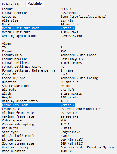

I said the video bitrate is variable as its frame rate both of them are variable (Frame Rate and Video Bitrate = Variable).
You can check it out (SS and video below):

As you know (better than me) videos with less motion or with more static frame contents, like part 2 of this video section which is showing an app UI and just have a little motion in centre of the frame (Aaron is designing a sticker on Adobe Illustrator) have better compression ratio. I think VBR and VFR would be better for these situations instead of constant rate for frame rate and video bit rate.
I have changed its VFR to 23, all things are good for me but the Aaron parts (person frames) are sluggish and is like slow motion. I want to change the VFR to variable (from CFR 60 to VFR 60) then anytime Aaron (person of frame with lot motion) appears the frame rate would be maximum and when the static part of video are appear frame rate would be less and video size decreases.

Note also that your seemingly VFR clip is really CFR, it is just that its framerate metadata is being mangled by that particular coding library.
I mean, come on... Average 59.94, High 59.96, Low 59.92? Variability of 0.02fps. That just means that it is having difficulty tracking the actual CFR of 59.94 using the chosen timebase (which is common in many mp4 libraries).
