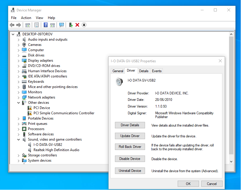

    We better get back to basics and ensure that your device drivers are properly installed.
    So what does Device manager report under Sound, Video and Game Controllers ? Do you see the actual device or some generic name that Windows has created ?
    [Attachment 61733 - Click to enlarge]
    Here is a screenshot.

    Ok. But a driver dated 2010 does not appear to be 'up to date'. I use Win7 and my Hauppauge driver is dated 2018. Long after Win7 was laid out to grass.
    But let's now move on to virtualdub and what do you see from the Device menu ?

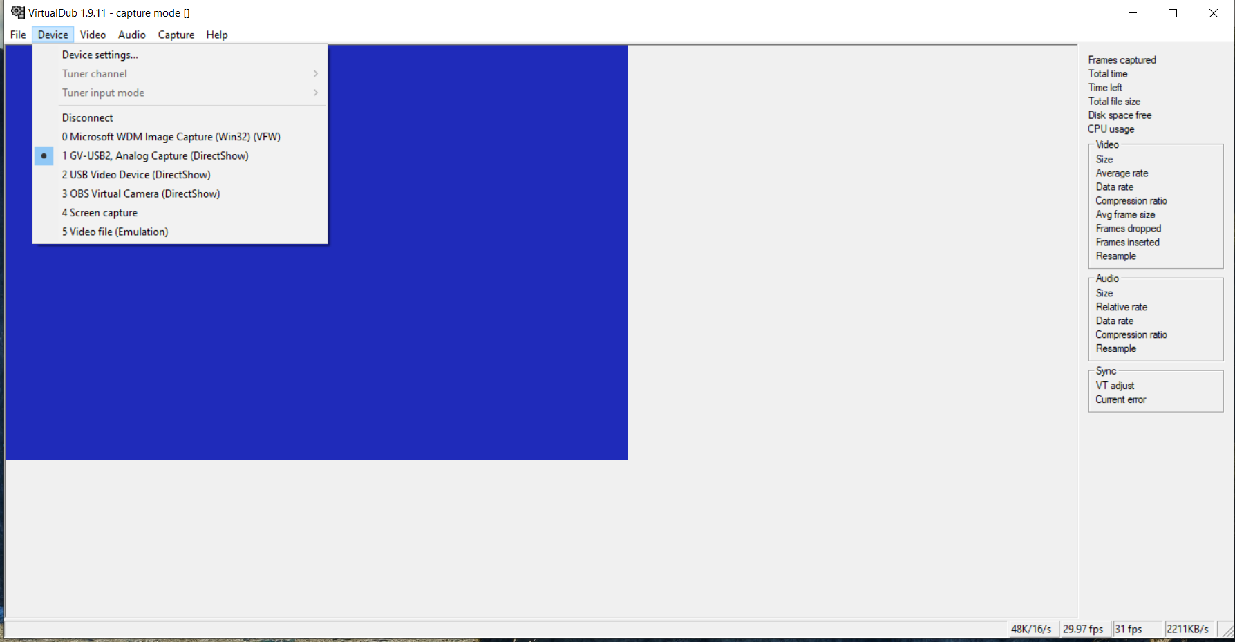

    Well according to your Device screen under virtualdub the device is expecting a NTSC signal. (Don't need a degree in IT to appreciate that - look at bottom right of screen )
    Now check the 'Capture Filter' settings.

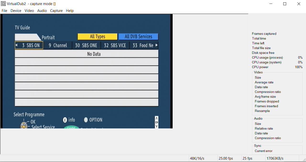

    So I set it to PAL_B in Virtualdub2 by going to Video --> Capture Filter --> Video Decoder --> Video. It works now and I get video. It's also in S-Video. Both PAL_B and PAL_G work. I also get passthrough from the video player to the DVD player. Virtualdub 1.9.11 on the other hand shows just a blank window. Image
    [Attachment 61793 - Click to enlarge]
    The picture is cut at the bottom as visible in the screenshot. How can I fix this?
    [Attachment 61792 - Click to enlarge]
    This is with the IO-DATA. I haven't gotten around to testing the Diamond VC500 yet.
  23. PAL should be captured at 720x576, 25 fps.
  24. Member DB83's Avatar
    Jul 2007
    There should be no visual difference between vdub2 and vdub. So check all settings including Capture Pin.
    That screen has not been generated by a vcr. The real test is live video.
