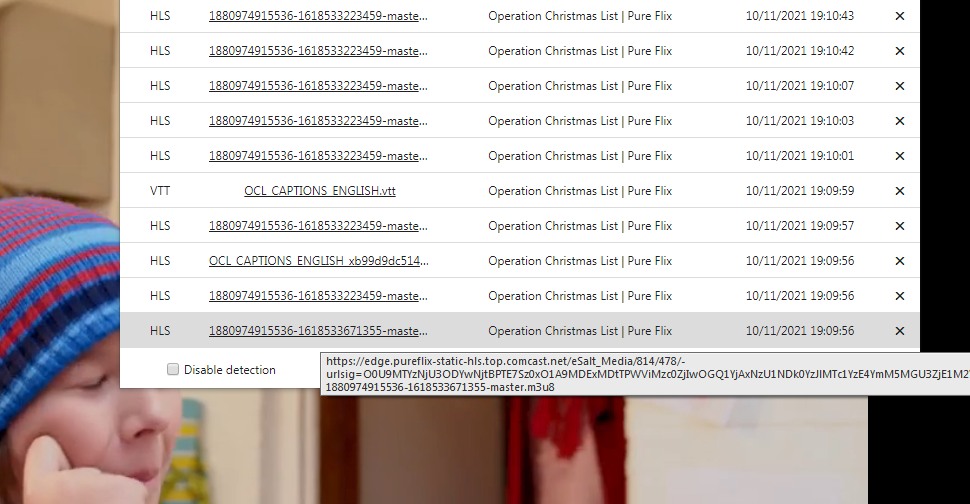

  10. when play full video, go to network tab. we have a lot of m3u8. search master here.
  11. Originally Posted by lomero View Post
    I saw it and I downloaded it. It is working fine.
    Thank you so much!

  13. Originally Posted by lomero View Post
    Ohhhhhh...... I didn't try that. I used IDM and grabbed the link that was shown there which happens to just a segment.
  14. IDM does not always work well...
    better see network tab. we have multiple m3u8.
