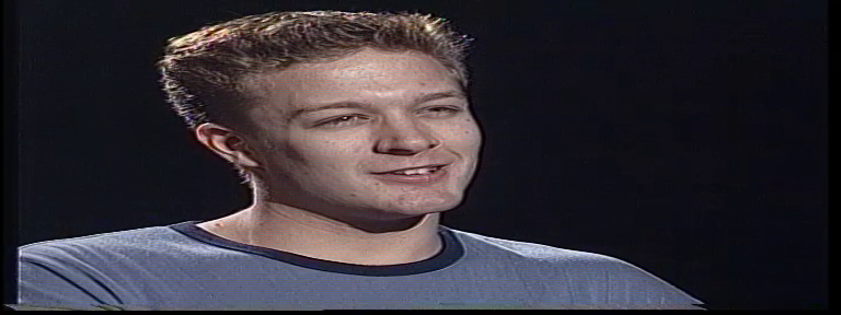

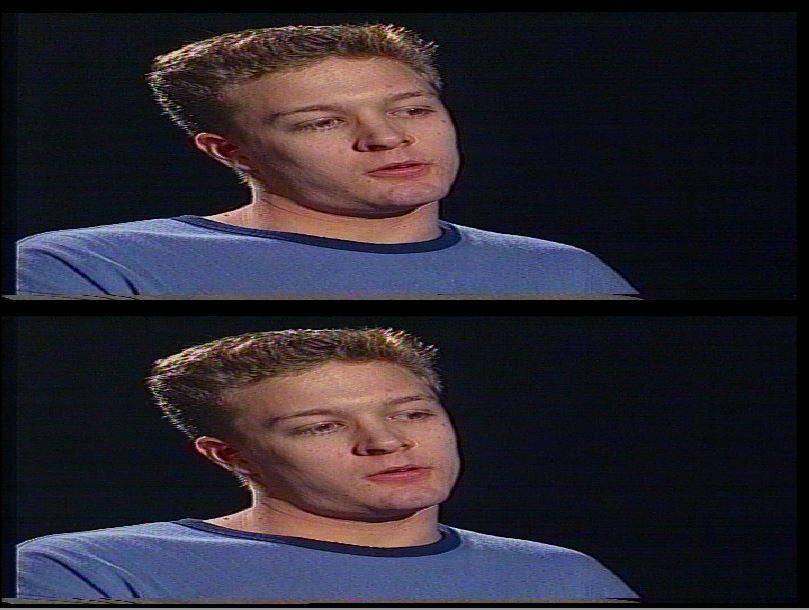

    I have been capturing some BetacamSP this week through a PVW-2800 (component output). I was confused when my image was looking very undersaturated even though analysis with vectorscope was showing good levels. After monitoring the image with side-by-side fields I realised that my top field has no chrominance signal, while the bottom field looks to be fine.
    This issue hasn't been happening with all the tapes I have so I'm hoping it's not a major issue with the VTR. Has anybody else had this issue or could give advice on whether it can be fixed.
    See an example in the image I've attached.

    Very simple. Thanks so much for that. I of course have sent the example with the fields separated. Is it easy enough to alter that script to copy the chroma from the bottom field to top field in an interleaved video? example pic attached.
  6. The interleaved fields png image does not display the same characteristics as the image in the 1st post in terms of chroma signal. Both fields have chroma signal, as if the signal has been comingled between scanlines. It might be from the way you converted to RGB for the png image
    Post #5 Top field
    [Attachment 61711 - Click to enlarge]
    Post #5 Bottom field
    [Attachment 61712 - Click to enlarge]
    But it would look like this, for the interleaved version
    #your source
    T=AssumeTFF().SeparateFields().SelectEven()
    B=AssumeTFF().SeparateFields().SelectOdd()
    Tfix = MergeChroma(T, B)
    Interleave(Tfix, B)
    Weave()
  7. Originally Posted by poisondeathray View Post
    Interesting, the original PNG file definitely has the top field chroma issue. Perhaps something to do with compression upon uploading here? Regardless, thank you for the script. Will give this a try and report back.
