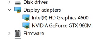

  7. Originally Posted by usually_quiet View Post
    WebM typically uses VP9 for 4K. Your i7-4720HQ processor provides Intel HD graphics 4600 and your post doesn't mention any other GPU. Intel HD graphics 4600 can't decode VP9 using Quick Sync Video, which means the 2160p60 video must be decoded with software using the CPU alone. That is a heavy lift for a CPU.
    Actually, my laptop has 2 graphics card. One is Intel. The other is a 2gb Nvidia GTX 960M.
    So, is there a way I can put the more powerful video card to use for these videos?
    [Attachment 61695 - Click to enlarge]
    Aug 2004
    PA USA
    Still not going to play that video, GTX960M supports H.264, VC1, MPEG2 1080p video decoder

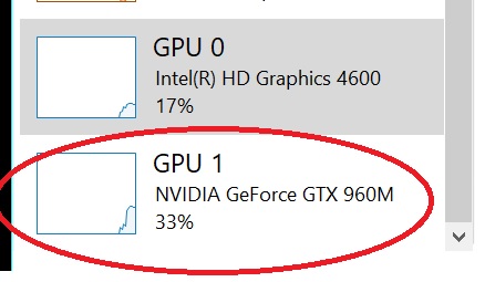

  20. I realized VLC doesn't use my GPU when I play heavy files:
    [Attachment 61984 - Click to enlarge]
    I still think if there is a way the software part can be optimized, my laptop can play 4k 60fps.

  22. Originally Posted by sum_guy View Post
    Some of the best minds (myself excluded) here on Videohelp have already explained, it won't play it. Time to bury the thread.
    It's funny you should say that. I actually found a way to make the NVIDIA my primary GPU processor and now my laptop plays 4k 60FPS smoothly!
    I realized NVIDIA wasn't being used before and I changed that.
    [Attachment 61986 - Click to enlarge]
