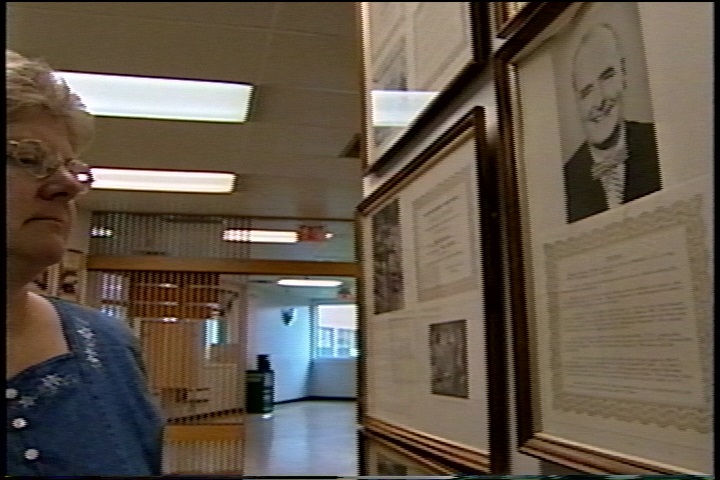

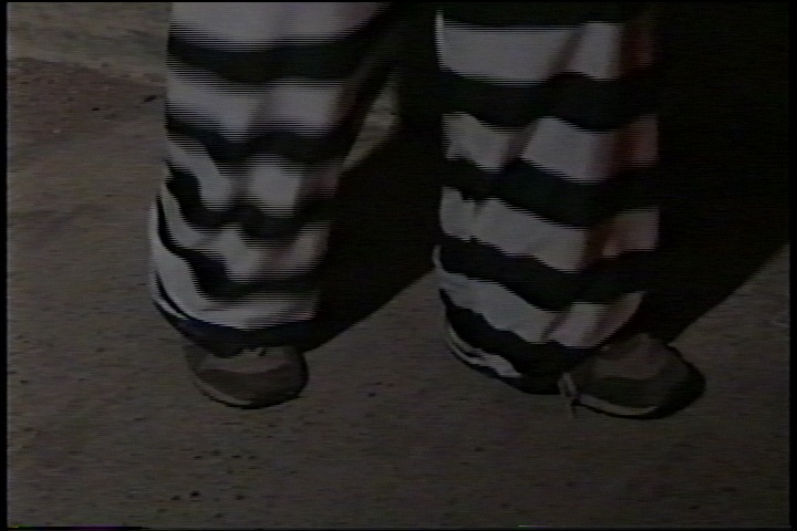

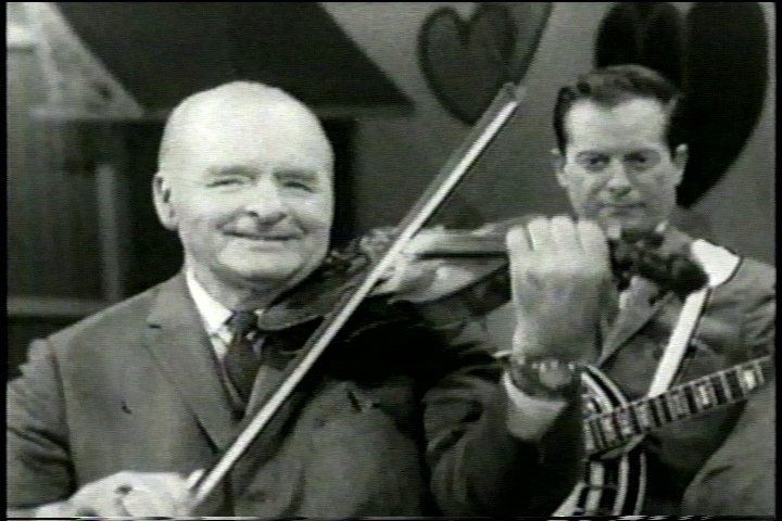

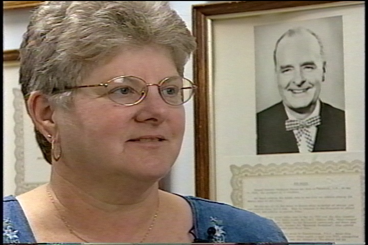

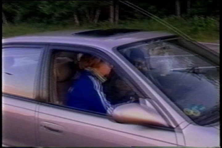

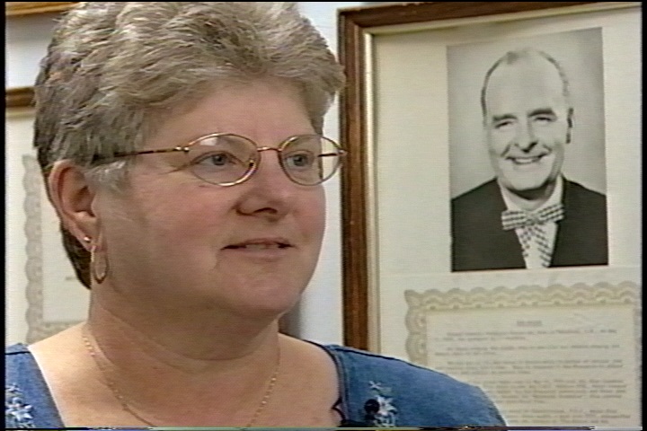

Since my VCR is not a professional one, I figured I should experiment. During my first capture with calibration turned off, the audio would slow down and speed up. I'm not sure why? Windows 10? Because calibration was turned off? The 2nd capture (of the same tape) with Calibration OFF, had no issues with the audio.
Here are some captures and I was hoping for some feedback with more trained eyes.
I captured them by stopping on the frame in VirtualDub 1.9.11 and doing Video > "Copy source frame to clipboard". Then pasted into MS paint and saved as a jpg.
Snapshots show first with video calibration ON and then 2nd is with calibration OFF (as per filename). I've also attached them as a zip file.
Snapshot 1:
[Attachment 61676 - Click to enlarge]
[Attachment 61677 - Click to enlarge]
Snapshot 2:
[Attachment 61678 - Click to enlarge]
[Attachment 61679 - Click to enlarge]
Snapshot 3:
[Attachment 61680 - Click to enlarge]
[Attachment 61681 - Click to enlarge]
Snapshot 4:
[Attachment 61682 - Click to enlarge]
[Attachment 61683 - Click to enlarge]
Snapshot 5:
[Attachment 61684 - Click to enlarge]
[Attachment 61685 - Click to enlarge]
So, I didn't notice much of a difference with the images.
However, with video calibration set to "ON", there were sync issues, with error ranging up to 300 ms, but often more in the 100 ms in range. For a 20 minute tape there would be 4-5 times it would happen.
With video calibration set to "OFF", there are appear to be no Sync issues.

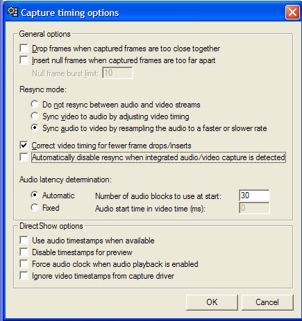

I have Virtual Dub "Timing" settings set as recommended by sanlyn here. (drop frames = no / insert null frames = no).
[Attachment 62425 - Click to enlarge] -
sanlyn made a mistake in his settings.
For example, by disabling the very top two options, you're essentially turning off the drop reporting. That doesn't prevent drop/insert frames, nor accurately capture.
Read my other posts in that thread.
VirtualDub's defaults are generally correct for most cards.
Turn off JVC calibration. That doesn't do what you think it does. (Nor is the manual accurate.)Want my help? Ask here! (not via PM!)
