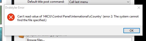

    When I try to install/run DVDStyler on my computer I get the following error message. Image
    [Attachment 61661 - Click to enlarge]
    What does this mean and what can I do about it?
  2. Member DB83's Avatar
    Jul 2007
    I can only but guess that the program is checking the registry to automatically select, in your case, NTSC for the dvd.
    The error is Windows related and I would check Control Panel >> Region >> Location to see what that reports (other than USA). But it appears from the message that the relevant file is missing from the registry (a faulty log-in or some other issue). If altering the setting in Control Panel does not solve the issue I would create a new topic in the Computer sub-forum.

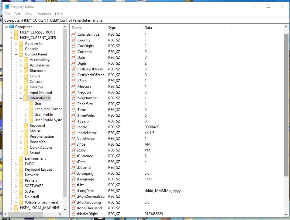

    Mar 2008
    Here's the entry in my own system, as can be seen, this key contains locale info.

    Mar 2009
    Does this image help things?
    [Attachment 61670 - Click to enlarge]
  5. Member DB83's Avatar
    Jul 2007
    The screen confirms that sCountry is missing from the registry (hence the error message)
    Now check the entry under Control Panel as I described earlier.

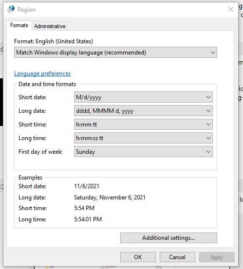

    Mar 2009
    [Attachment 61672 - Click to enlarge]
    Where do I go from here?
  7. Member DB83's Avatar
    Jul 2007
    Well if your version of Windows (?) works like mine (7) there are two tabs missing >> 'Location' (which should have shown 'United States') and 'Keyboard and Languages'.
    Of course if these tabs are created from the registry entries it would explain why there is no Location tab since sCountry is missing from the registry.
    I would not be confident enough to advise you to create the actual entry direct in the registry but suggest you create a topic in the Computer sub-forum such as 'Missing entries in registry and Control Panel'. But do check if your Windows has other Control Panel entries.
    Only you can answer how you are logging in or you have some utility that 'hides' certain registry entries. But, as I stated, this issue is not specific to this software and needs to be addressed elsewhere.

    Mar 2008
    Try setting the top pulldown like this, then check the registry and confirm it added the missing value
    If it did not, add it manually. In the left pane, right click "International" / new string value
    Value: United States

  13. Here's the fix in the usa:
    Windows Registry Editor Version 5.00
    [HKEY_CURRENT_USER\Control Panel\International]
    "sCountry"="United States"
