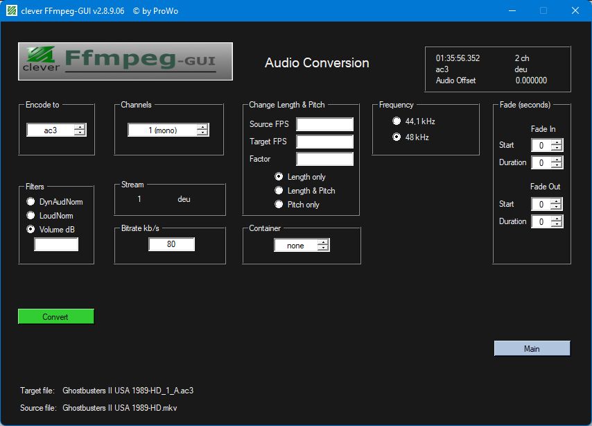

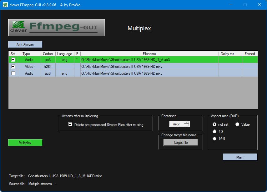

  7. Another totally free program to try which may work is clever FFmpeg available on this site.
  8. This one is simpler to use. Clever FFmpeg GUI
  9. You can do this very easily with clever FFmpeg-GUI.
    Follow the instructions carefully the first time you start it.
    Then load your video, click main, click convert audio stream, click continue, set channels to 1(mono), leave everything else as it is, click convert.
    [Attachment 61662 - Click to enlarge]
    Click multiplex, the newly created audio mono stream is green, deselect the old audio stream and click multiplex.
    [Attachment 61663 - Click to enlarge]
    Done.
    Done.
    Thanks! This worked really well.
