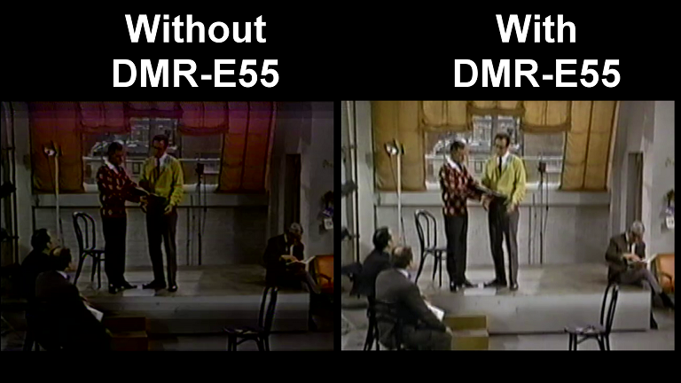

  19. I have three of these units now (can't pass them up in the thrift store when I see them!) - an ES10, an E55, and an EH55. The ES10 might do a better job like you guys claim, but I find it hard to tell. I plan on doing a direct comparison some day when I get a chance.
    In the meantime, I tested my most recent purchase (the E55) using a VERY poor quality tape (and ghetto setup... cheap VCR and elcrapo usb capture device) to see how the E55 fares. It's not perfect, but it sure improved things a bunch!
    Here's the comparison, click to watch the clip. And now that I think about it, I forgot to enable DNR, which might help with the flickering even more:
  20. Video Restorer lordsmurf's Avatar
    That E55 is doing a pretty crappy job. Better than the source, sure. But still not really fixed, and in fact actually adds some errors. Values are boosted illegal. This is what happens when a weak "TBC" (not really TBC by capture/ingest definitions) is used. I've yet to be convinced that the E55 is the same caliber as the ES10/15 units.
    DNR doesn't help flicker, not for motion issues.

    From the video you posted even after the E55 the quality looks horrible, With only a decent VCR and a good capture device the quality you get would look much better than the output from that DVD recorder. This is the kind of problems a DVD recorder cannot fix. What is the output quality from the ES10 looks like?

    As for that video, it looks like there is some issue with the vertical sync area on that tape, could be it was recorded with bad alignment or maybe the head switching was messed up or something else, it's a bit hard to tell from the video. Also noticing a white streak at the upper left so maybe that's related. So, I'm a bit skeptical that a different VCR would make a significant difference (and highly doubt a different capture card would make any difference behind the dvd recorder). Something like a datavideo TBC could maybe end up "jumping" less but it might not handle it as well in other ways. The E55 is certainly helping to a degree, would have to do the same test with the ES10 to see if it does any better, but yeah looks like it at least has some degree of stabilization as noted with the PAL variants.

    I agree with what OLN wrote. It is definitely an improvement over recording without DMR. It would be interesting to see if the video & audio stay syncronous when capturing with and without the E55.
    Even with an ATI600 USB or AIW capture card, your capture without E55 should be terrible and audio & video not syncronous because of dropouts. Basically I think it could be only one capture card that might be able to do that.
    I doubt that using a Datavideo TBC-1000 or an ES10 will improve things. Especially with PAL equipment, I don't see much difference between an E55 & ES10.
    But it is a good example that you have to adapt the hardware to the tape you want to record. That's why some people have a wider range of equipment to be able to record difficult tapes.
    I would try, if capturing with the ES10 does not bring any improvement, to use another player in connection with an E55 or ES10 or a VCR with Line-TBC.

    I also agree with Bogilein and Oln, as usual. Capture card will not solve anything here, except maybe a Canopus RX or a BrightEye 75. A better VCR may solve some issue, but it will be marginal. A frame TBC may not fix everything as well.
    The choice between the lineTBC correction of a different VCR and the correction of a Panasonic in pass-through mode has to be verified on field, difficult to asses before trying.

  28. Originally Posted by Sharc View Post
    Also, when doing sequential repeated tests for comparison, the analog signal from the tape player (VCR) will never be the same between tests (not 100% reproducible analog source, glitches, noise, etc.) which can make the comparison sometimes difficult.
    Agreed... so take the following test with a grain of salt.
    I pulled out all 3 units, and did 6 separate captures with and without DNR enabled. It seems enabling DNR on the EH55 does improve things a bit.
    The ES10 as you folks predicted does indeed seem to do a better job than the other 2 units.
    Here are the raw files if anyone wants to compare outside of YouTube: https://drive.google.com/drive/folders/1g6mA6_aBVZ7cr9Ote1DF1ndt53wCz7fc?usp=sharing
    And here is the comparison on YouTube:
