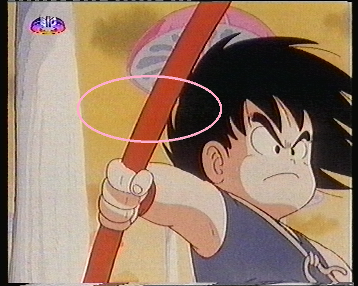

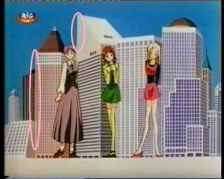

    The thing is, it's not the tape that is in bad condition; despite its 31 years of age, it's remarkably in good shape! In fact, all of these 4 excerpts come from that very tape (Dragon Ball was recorded in 1996 while Telecinco in 1991).
    The poor signal recordings were RF recordings from video signal 30km from the Spanish border (the Telecinco channel) in relation to our holiday rented apartment in Portugal. The Spanish RF signal strength and quality varied according to the atmospheric conditions at each recording, or even during the same recording. On the other hand, there were several occasions where the Spanish RF signal was very good, almost the same as the national Portuguese TV channels.

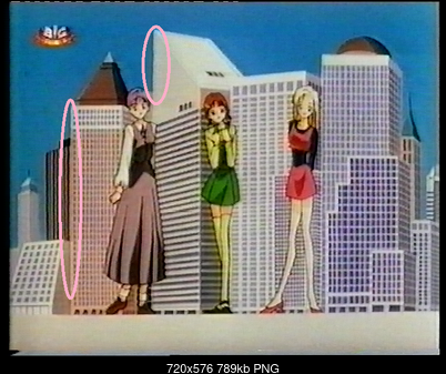

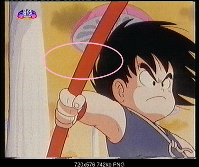

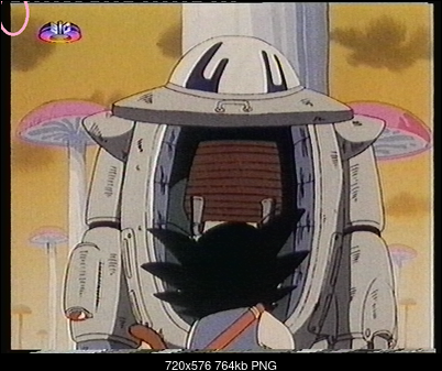

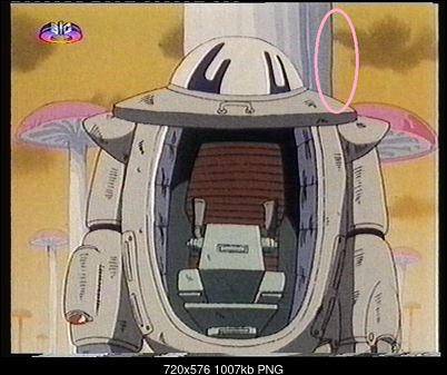

    Anyway, regarding the good recordings, what do you think? Could a lineTBC help improving the overall quality in some way (especially the first-generation copy)?
  18. Captures & Restoration lollo's Avatar
    Jul 2018
    Italy
    The captures are not too bad considering the non optimal reception (and then the recording) you mentioned.
    An ES10/ES15 can help in straightening the vertical lines, and reduce the occasional wiggling and the occasional flagging, together with a generic intraframe and interframe cleanup, as oln properly said:

    One of the main problem is the strong halo, try to reduce/remove any sharpening in the VCR or in the capture card:

    Excellent advice, I didn't notice those artifacts and video deformations.
    I guess I'll go with a ES10, then.
