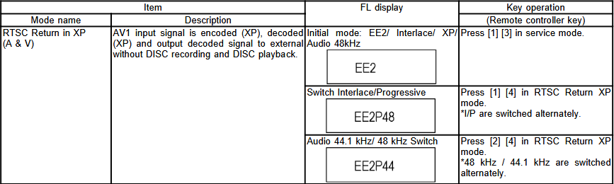

    Hello, I'm currently ripping my family recordings and I'm encountering a problem - some of my tapes are physically damaged at some points (you can hear a louder tape transport in the VCR and a noisy strip comes through the screen), my Panasonic DMR EH585 detects this as copy-protected content and stops recording. Is there a workaround for this problem or do I have to manually rewind the damaged parts?
    Aug 2018
    Wrocław
    Rewind.
    Not to mention that ripping to MPEG2 is a bad idea. And certainly not with this Panasonic.
    Aug 2018
    Wrocław
    By the way, looking through the Service Manual for my recorder I found such an option, which in theory is full passthrough (maybe it will be useful to someone, but it only works rather for analog output):
    [Attachment 85592 - Click to enlarge]
    I think by default it's off and you have full pass-through. In service mode you can enable compression and decompression and thus reduce quality.

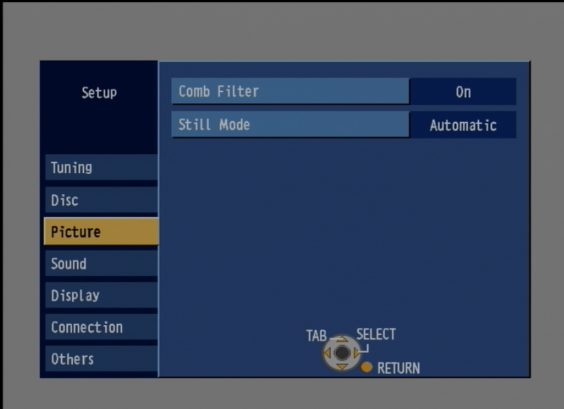

    I will thoroughly read the thread to see if there's anything I can learn later. Though my ES10 menu doesn't seem to have anything relating to NR?
    May 2005
    Australia-PAL Land
    This is for my ES-15, but it should be the same for your ES-10: on your remote, hit the Display button. Then go to Picture. The AV In NR menu will pop up. Turn NR off.
