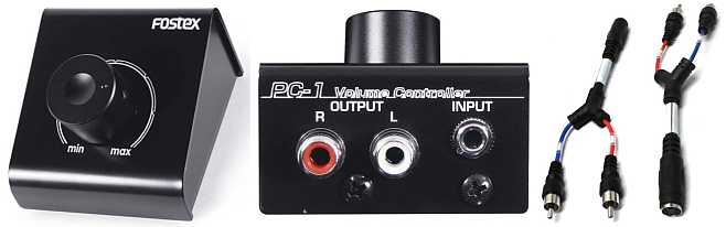

    You have to reduce the brightness signal in the analogue signal path before it goes into the DMR, up to the point where the AGC of the DMR no longer adjusts.
    This can be done by means of a potentiometer, either with a composite cable or with S-Video if you use such cables.
    [Attachment 83482 - Click to enlarge]
    Originally Posted by Gubel
    "Google Translation from german gleitz video board"
    Then I came up with the idea of ​​looping in a simple (passive!) volume control potentiometer for audio line signals:
    The device has a stereo jack input and a stereo cinch output. So you need a jack-cinch (audio) cable and a cinch-cinch video cable.
    Since it is a stereo potentiometer you can use either the "red" (right) or "white" (left) cinch (it just has to be the same on input and output ;D).
    The potentiometer loads the (normally audio) source with 8kOhm and regulates the output signal according to the voltage divider principle.
    Now the DMR recorder of course (correctly) has an AGC at the input. This pulls the video signal down to the (1Vp-p) standard level based on the burst signals (has nothing to do with the IMAGE CONTENT! - except that with real analog camera sensors this can actually be above the standard level (1 Vp-p), whereby the overload can go well beyond the super value range 235...255).
    If you now reduce the level of the entire video signal (which we do with a simple potentiometer), you also lower the signal burst level - and the AGC in the DMR adjusts accordingly. However, this "only" has a control range of approx. 0.5 to 2 Vp-p. So if you reduce the level below 0.5 V, the AGC can no longer "catch up" - and FROM THEN the image actually becomes "darker"!
    The black point does NOT shift in the process! I also noticed absolutely NO deterioration in the signal (streaks, blurring)!
    You need a bit of "feel" when adjusting. While adjusting, the picture flickers and pumps immensely. It is also not "much" below the maximum setting, because -50% level (-6dB) is not all that much for a volume control.
    So you proceed as follows:
    1. Loop the potentiometer into the FBAS line between the VCR and the Panasonic DMR and set it to MAX!
    2. Look for a tape section with oversaturated areas (long scene, or switch to freeze frame)
    3. Now adjust the potentiometer very carefully (!) until the AGC no longer adjusts and the white point is sufficiently lowered
    ...the potentiometer should ideally be placed a little way away from the device on a stable surface so that nothing moves (including the cable) and there are no vibrations - otherwise you will quickly end up with interference and brightness pumping. Once you have found the right pivot point, don't touch it again!
    !! The whole thing is of course a "amateur method", but it works!!
    (The correction can only be made on the direct source signal (regardless of whether it is done via potentiometer or proc amp) - not possible, for example, behind recorders with a "TBC" function)

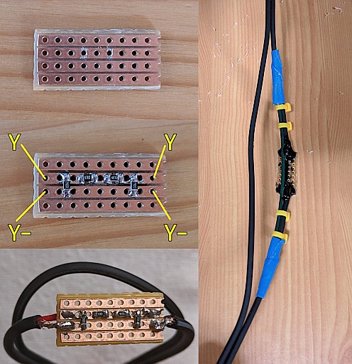

    In order to properly digitize Video8 and Hi8 cassettes, I bought a Blackmagic Intensity Pro and a Panasonic DMR-EH495. Unfortunately, as I feared, the luminance channel is noticeably overdriven. For the best possible quality, only transmission via S-Video is possible. So I had to bite the bullet and get an S-Video cable. A simple voltage divider with a potentiometer can be problematic because the video signals are transmitted with 75 ohm input and output impedance. These are signals with several megahertz that are easily reflected if the impedance is poorly matched and cause visible image errors. The solution is an attenuator designed for 75 ohms . I built it as a Pi circuit with 0805 resistors on a strip grid board to keep unwanted inductance/capacitance as low as possible:
    -5.6dB attenuation (Pi circuit with 2x240 ohms between Y and Y- and 51.7 ohms in series with the luminance signal Y) has proven to be optimal for well-controlled video. There were no fluctuations between the cassettes, regardless of whether they were Video8 or Hi8. All cassettes were played on a Hi8 camcorder. The chrominance channel does not need to be adjusted, it is transmitted with a lower voltage anyway. Despite the reduced luminance level, there are no oversaturated colors. Here is another example: Hi8 still image with waveform display for Y, Cb and Cr:
    There are still a few isolated peaks in the "forbidden" super white area - but a stronger attenuation does not reveal any additional image information because these areas of the image were already overexposed when the picture was taken. I tried digitizing with even stronger attenuation. The result was gray highlights and unused resolution of the brightness values.
